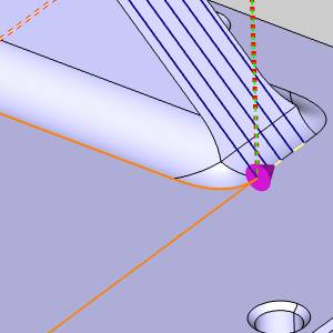

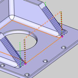

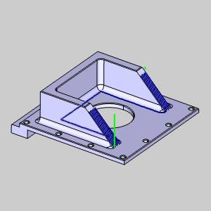

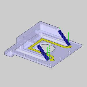

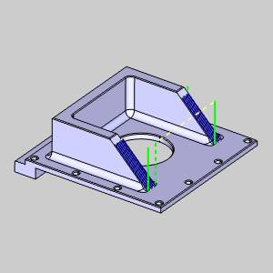

On our example part, we have created an Advanced Planar toolpath, and have used boundaries to isolate it on the angled surfaces of our part. In this case, the toolpath has been separated into two separate regions, and those regions are connected with a rapid. It is this rapid we will replace with a feed move that traces around the inner fillet in the direction seen below.
  1. In the CAM Tree, click the Advanced Planar operation of the Feature 3 Axisto highlight the toolpath in the graphics area.
    Take a moment to look at the existing linking between toolpath regions to see what we intend to accomplish.
  1. Right-click the Advanced Planar operation of theFeature 3 Axis.
  2. Select Edit Toolpath.

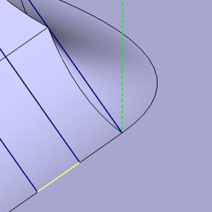

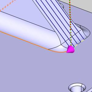

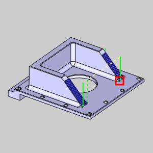

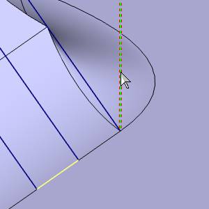

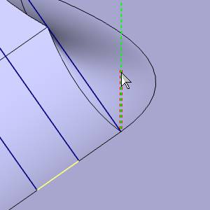

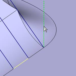

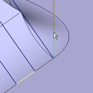

  1. In the graphics area, zoom into the area shown in the image below.
  2. Hover over the lower portion of the retract move and click on the toolpath element shown below.
Important: If the toolpath elements that highlights is not the first move of the rapid, as in the image below, be sure to include the first toolpath element in your selection as well.
  1. Zoom out in order to bring the entire model back into view.

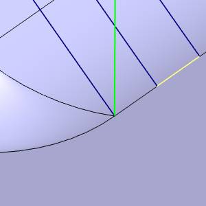

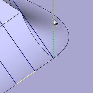

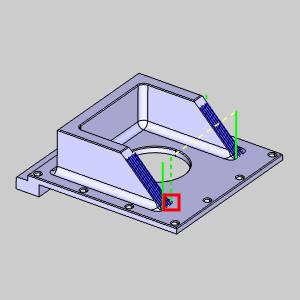

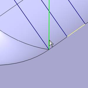

  2. Now, zoom into the area shown in the image below.

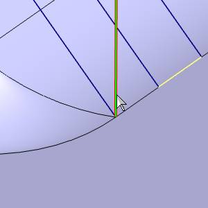

  3. Move your mouse to the end of the green toolpath element.
  4. Press and hold Shift and click the bottom of the toolpath element to perform a chain selection of all the toolpath elements between.

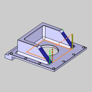

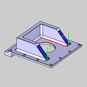

  1. In the Parametersgroup, click the Pick button to begin selecting the Toolpath Chain.
  2. Select the five individual edges on the model, as shown in the images below.
  3. With the five edges selected, right-click and selectOK.

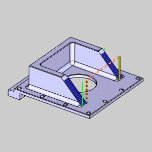

    The executable preview displays.

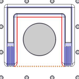

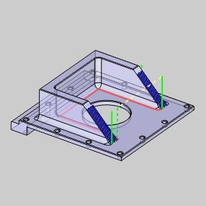

In some cases, depending on the direction of the Toolpath Chain, the preview may show an unintentional result, as shown in the image below. In these cases, we would need to Reverse Direction.
  1. In the Toolpath Chain list, click on Chain 1 to highlight it.
    The Chain highlights and shows directional arrows.
  2. Right-click Chain 1 in the Toolpath Chain list and select Reverse Direction if the chain is not moving in the X negative direction.
    The preview updates if the chain is reversed.
