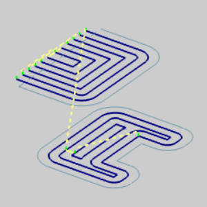

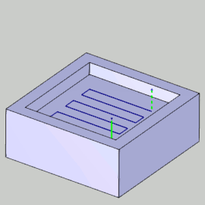

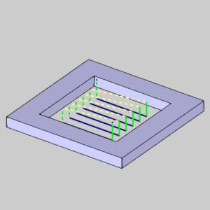

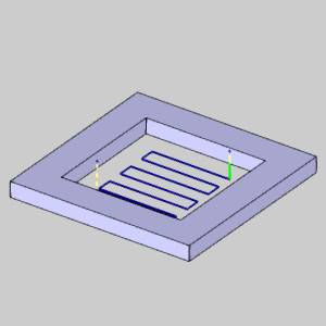

Parallel - creates a pattern of parallel cuts where the tool feeds in both directions. With this pattern, you can select either No Profile, Profile After, or Profile Before, from the Final Contour group.

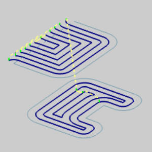

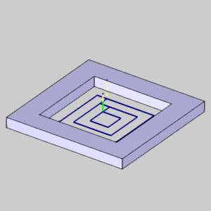

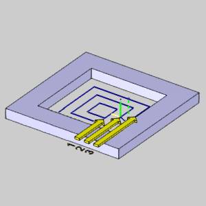

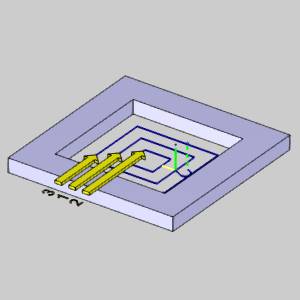

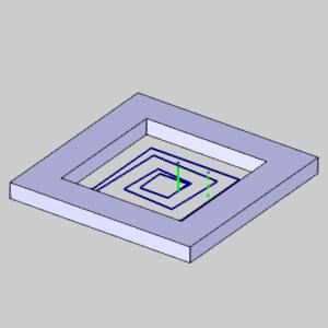

Offset Pocket Out - creates a pocket pattern which continually offsets the inner shape of the pocket and creates the toolpath from the inside-out.
Offset Pocket In - creates a pocket pattern which continually offsets the outer shape of the pocket and creates the toolpath from the outside-in.

Parallel - creates a pattern of parallel cuts where the tool feeds in a single direction. With this pattern, you can select either No Profile, or Profile After, from the Final Contour group.

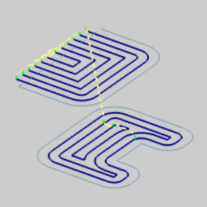

Offset Pocket In - creates a pocket pattern which continually offsets the outer shape of the pocket and creates the toolpath from the outside-in. This option is different in that the first cut, which is against the wall of the pocket is skipped until the rest of the pocket is cleared out.

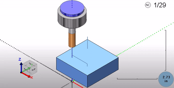

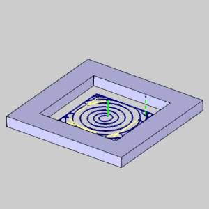

Standard Pocket Advanced Pocket Morph Spiral - creates a pocket pattern which combines a spiral and the offset shape of the pocket in order to eliminate linking moves. A morph is only applied in situations creating a closed contour. Open pockets will not always be able to utilize the morph pattern.

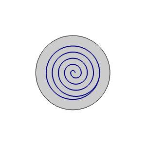

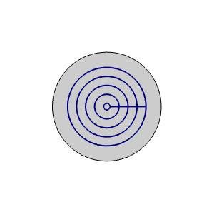

Use Spiral for Circular Pockets - Spiral pockets give the user the ability to create spiral toolpath instead of the standard offset toolpath for circular pockets. This option is not available when using the Morph Spiral, or Adaptive Roughing patterns.
Select the check box to a override the previously selected pattern in favor of a spiral pocketing method on circular pockets.
While the check box remains unselected, the currently selected pattern will be applied to all geometry, including circles.

Final Contour - This group becomes available when the Parallel pattern is selected.
No Profile - No finish pass is calculated.
Profile After - A finish pass is added to remove the material from the pocket after the pattern is applied.
Profile Before - A finish pass is added to remove the material from the pocket before the pattern is applied. This option is not available when using the Advanced Pocket.

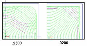

Sharp Corner - This group becomes available when the Parallel pattern is selected.
Open Convex Corners Only - applies the Sharp Corners only to the open areas of the pockets. This can be helpful to avoid roll overs which may interfere with nearby part walls which should not be contacted with the tool.
All Convex Corners - applies Sharp Corners to all areas of the pocket, whether opened or closed.
- Smooth Radius in % of Stepover - is the value for the amount of smoothing measured from the original contour and the rounded corner.

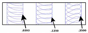

- Stepover % - sets how much of the tool is used for the distance between passes.

- Minimal Curvature Radius - determines the smallest radius used in the toolpath motion. This value must be greater than zero, but be aware that if you set this value too high, no toolpath is created. This parameter is useful, for example, to determine how far into a corner the toolpath can reach.

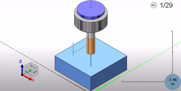

Select the check box to apply a tangent move to the link connection. The specified radius can be anywhere from 0, to half the step over. Notice in the animation below, arcs of a specified size can be applied to the link move.
