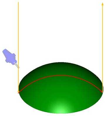

Direct
- applies an approach to the drive surface with no lead-in or lead-out.
The feedrate is rapid. The tool axis orientation during direct entry
is the Z-axis.

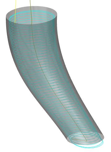

Retract
to clearance area through tube center - retracts the
tool to the Clearance Area through the center of a tube. This option is not used for 3 Axis features.

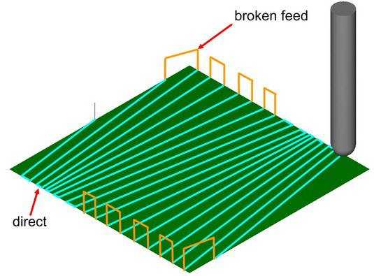

Direct
- treats the gap as if it doesn't exist and links the toolpath segments
directly with no retract.

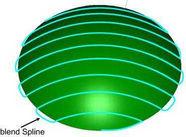

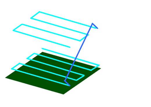

Blend
spline - creates a spline that is blended between the two
surfaces to link the toolpath segments:
Retract
to feed distance - causes the tool to retract to the Feed
distance value before connecting to the next toolpath segment.

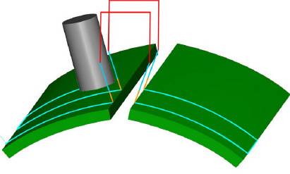

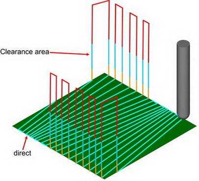

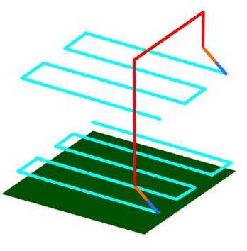

Retract
to clearance area - causes the tool to retract to the Clearance
area before connecting to the next toolpath segment.

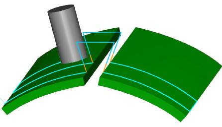

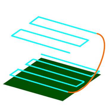

Clearance blend spline - enables two contours to be linked with a new blend spline. This option is only available for the Advanced Rough and Flatlands toolpaths.

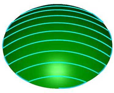

Follow
surfaces - attempts to follow the geometry surface and
create a toolpath as if the geometry is closed.

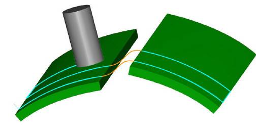

Blend

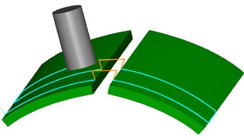

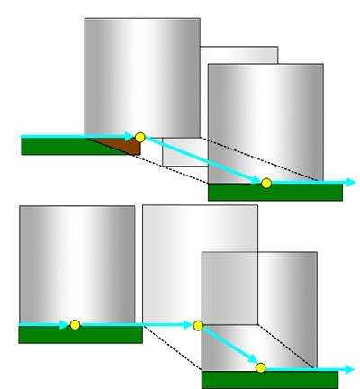

Step
- creates a step to link toolpath segments when needed.

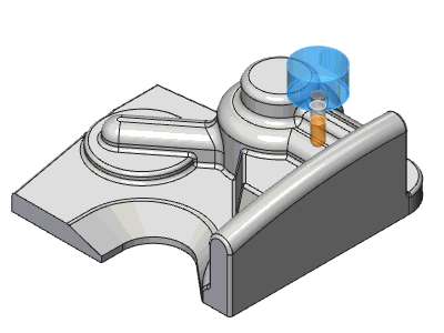

Shortest path
- This option creates links at the specified air move safety distance height. The links follow the shape of the machining surface to avoid undesired tool retracts and prevent scratches to the finishing surface.

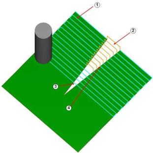

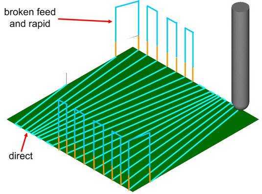

Small Gap Size - sets the threshold size for small gaps in one of two ways.
In % of Tool Diameter - is a percentage of the tool diameter.
As Value - determines the actual size of small gaps.
Note: The following image shows small gaps (3) with
Direct selected, and large gaps (4) with Retract to Feed Distance (2).

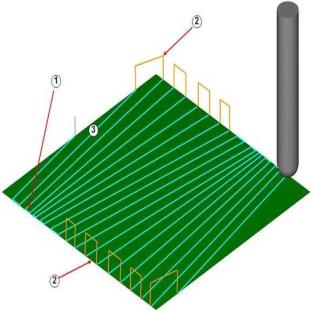

Small Move Size - sets the threshold size for small moves in one of two ways.
As Value - determines the actual size of small moves.
Note: The following image shows small moves (1)
with Direct selected, and large gaps (2) with Retract to Feed Distance.

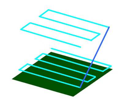

Links Between Passes
This group becomes available when using the Multi passes option found on the Roughing tab of the Advanced Planar toolpath.
Small moves / Large moves - The Small Gaps and Large Gaps items share the same options as listed next.
Direct
- links the toolpath passes directly with no retract.
Follow surfaces - links the toolpath passes by following the surface.

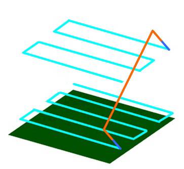

Retract
distance value before connecting to the next toolpath pass.
Retract
to rapid distance - causes the tool to retract to the Rapid
Retract
area before connecting to the next toolpath pass.
Small Move as Value - sets the threshold size for small moves.
