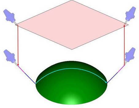

The Retracts dialog handles all of the clearance area and retract options for features in the Advanced UI. The clearance area is a retraction area specified by a certain shape. This area is where the tool can safely travel around the part, without causing gouges. The clearance area uses rapid feedrate.

- Direction
- is the direction in which the tool retracts to reach the clearance
plane.
- X-Axis
- the tool retracts in the X-axis direction.
- Y-Axis
- the tool retracts in the Y-axis direction.
- Z-Axis
- the tool retracts in the Z-axis direction.
- User
defined direction - once this option is selected, click
to open
the Pick dialog box. You can type coordinates, or click Pick
to select line or point geometry to set the direction vector. - Machining direction - sets the normal vector of the plane to align with the machining direction.

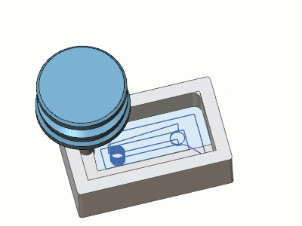

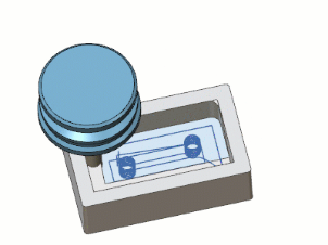

- Optimize lead and link distances - The improved in-process-stock awareness optimizes link heights and keeps them to a minimum. This reduces linking motions by up to 30% and therefore reduces machining time while maintaining machining safety.
Optimized Link Height Normal Link Height
Optimized Ramp Height Normal Ramp Height

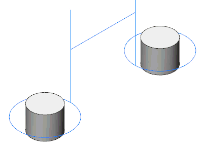

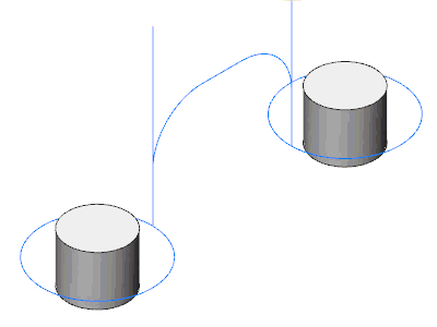

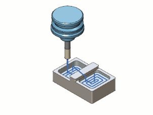

Arc fit
The Arc Fit group can be used to define an arc move to fit the connections of Retract to Feed Distance, Retract to Rapid Distance, and Retract to Clearance Area retract options. This replaces the linear move between retracts with the specified arc move.
To create an arc fit between retract moves for any of the available options: Clearance Area, Rapid Distance, or Feed Distance, click to select the check box and type a value in the Arc Radius box. You can only specify one arc radius value, but it can be applied to any or all of the retracts types at the same time.
- Arc fit off:
- Arc fit on:
