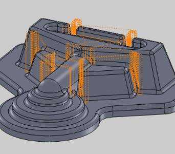

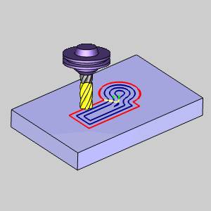

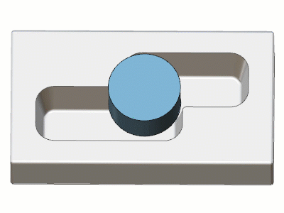

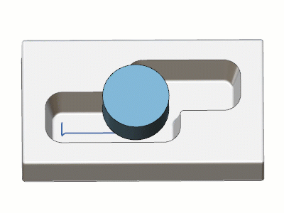

Machine Flatlands
Flatlands is designed to finish flat areas of a part, and it is best suited for machining large flat areas at multiple Z-levels.
- Clear this check box to not allow flatland machining.
- Select this check box to allow flatland detection which creates an optimized finishing toolpath for flat areas.
  • Min. Width of Flatlands - sets the minimum width of flat areas that are included in the flatlands machining.
  • Max. Width of Flatlands - sets the maximum width of flat areas that are included in the flatlands machining.
    - Clear the check box to only set a minimum width of flat areas that are included.
    - Select the check box to set a maximum width of flat areas that are included.
Important: The Flatlands feature must use flat-end mills or bullnose mills.
Flatlands Flatlands

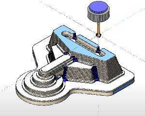

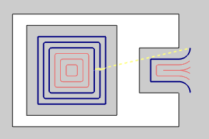

Stock
  • Stock Has Undercuts - allows you to trim the toolpath to account for voids below the first cuts made to the stock.
    - Once a cut is applied to the stock, all cuts under that location are also made.
    - Each depth of cut is checked to ensure there is stock to be removed, and toolpath is trimmed as needed if no stock is found.
    • Axial Shift - offsets the trimmed area down so additional cuts are made.
Stock Has Undercuts
Stock Has Undercuts
Stock Has Undercuts
+ Axial Shift

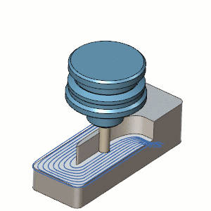

Smoothing
This group is available when the Cut Pattern on the Patterns page is set to Offset Out, Offset In, or Morph Spiral. When the Parallel option is selected, only the Smooth Final Contour option is available in this group.

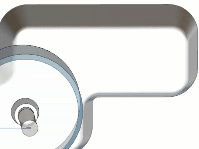

  • Smooth Corners
    - Select the check box to create fillets in the sharp corners of the toolpath. The fillet is not applied to the outer contour as it is with Smooth Final Contour. When selected, the Smooth Distance/Stepover % parameter becomes available as well as the Smooth Final Contour option.
    - Clear the check box to turn off Smooth Corners.
    • Smooth Distance/Stepover % - With the Smooth Corners check box selected, the Smooth Distance/Setpover % sets the radius of the fillet as a percentage of the stepover distance.
  • Smooth Final Contours - This option becomes available when the Smooth Corners option is also selected.
    - With the check box cleared, the Smooth Final Contour option is not used.
    - Select the check box to create fillets in the sharp corners of outer contours. The Smooth Distance/Stepover % parameter becomes available.
    • Smooth Distance/Stepover % - sets the radius of the fillet as a percentage of the stepover distance.
  • Smooth Contours
    - With the check box cleared, the Smooth Contours option is not used.
    - Select the check box to smooth the offset pattern based on the Deviation/Stepover % allowance, which becomes available when this option is selected.
    • Smooth Deviation/Stepover % - sets the allowable deviation from the original offset pattern.
  • Smooth Links
    - Select the check box to smooth the links within a group. The last segments of the previous contour and the first segments of the next contour are trimmed. The connecting link connects diagonally. In the case of an S-Link the connection is an S-type link.
    - Clear the check box to turn off Smooth Links.

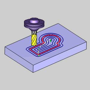

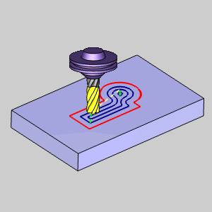

  • Start Points
    - With this check box cleared, no special consideration will be made when beginning the next pass.
    - With this check box selected, the start of the next pass will be shifted by the specified amount.
    • Shift Distance/Stepover % - allows you to set a distance that will force each pass to be started the specified distance further along than the last was started.

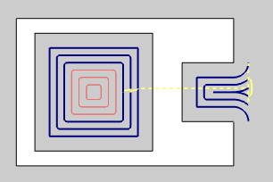

  • Minimize Links - When using the Offset Pocket Out and the Morph Spiral Advanced Pocket patterns this option can be selected to help keep the tool down for as much of the operation as possible.
    With this check box selected, the links are adjusted in a way which attempts to use part of the actual toolpath contour for linking instead of applying retraction moves.
    With this check box cleared, no additional optimizations will be attempted on the links.
    Minimize LinksMinimize Links

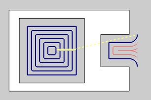

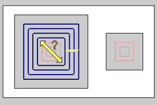

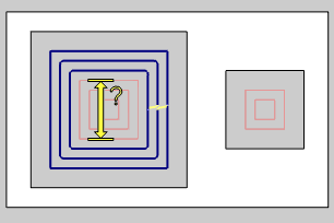

Remove Small Regions/Contours
These options allow you to remove small pockets and segments which are not necessary to machine. The size of these segments must be defined as a percentage of the tool diameter. (Threshold Value in % of Tool Diameter)

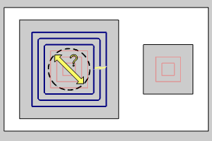

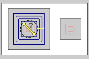

  • Filter by - These options allow you to determine the type of areas being considered for elimination. The Filter by options are only available when using the Offset Out, Offset In, and Morph Spiral cut pattern options.
    • ClosedRegions - A region can be defined as an area which can be handled without the need for a retract to clearance move. By selecting regions to filter, areas under the specified value will be ignored.
    • Regions
      • Type - allows you to define how the size is defined. Choose between:
        • Inscribed Circle - uses the width of the region as a maximum circle diameter, which could be inscribed into the toolpath within this region. With this type, any regions, or contours coming in contact with the boundary are eliminated from the toolpath.
        • Diagonal Length - uses the width of the region is a diagonal of the axis-aligned bounding box built around the toolpath within this region.
        • Circumscribed Circle - consolidates the diagonal length and inscribed circle types. With this type, any regions, or contours within, and not meeting or exceeding, the boundary are eliminated from the toolpath.

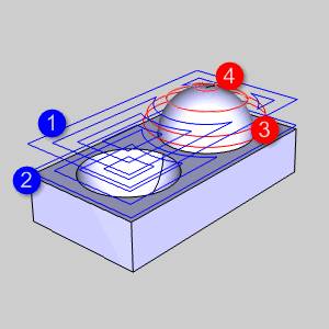

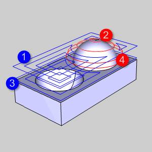

Tip: The images below show the results of the various combinations of filtering by type.

  • By Area - machines an entire area of the part before moving on to the next.
  • By Level - machines all areas of the part to the current pass depth before beginning the next pass.
Intermediate Steps
  • After Last Depth Step - cuts all intermediate slices for the entire model after the final depth step of the operation.
  • After Each Depth Step - cuts the intermediate slices for each depth step immediately after finishing each depth.
