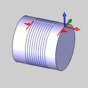

  • Start
    Select the check box to enable the Start setting. Type a value to define the start of the toolpath from the Machine Setup, along the selected Rotary Axis Direction.
    Clear the check box when not setting a Start limit.
    • Start - sets the beginning of the toolpath along the rotary axis. This value is from the Machine Setup or machining origin.

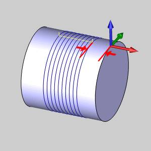

  • End
    Select the check box to enable the End limit setting. Type a value for the End of the toolpath from the Machine Setup, along the selected Rotary Axis Direction.
    Clear the check box when not setting a End limit.
    • End - sets the end of the toolpath along the rotary axis. This value is from the Machine Setup or machining origin.

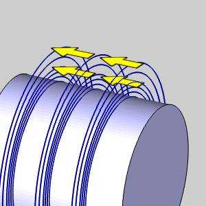

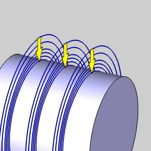

    • Sort by - defines the cutting order for multiple passes.
      • Slices - cuts the total depth of each slice before moving on to the next pass.
      • Passes - cuts the defined depth of each pass before moving to the next pass.
