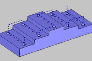

- Standard Drill
Standard drilling, the default drilling
type, is used when the tool orientation to drill the holes is
parallel to the main spindle direction, usually the Z-axis. This
includes face drilling for Mill Turn jobs. Standard drilling may
also be used with index systems, for example, with 3x2 machining
on a 5-axis machine where you index to a plane and then perform
3-axis machining (although multiaxis drilling eliminates the need
to create index systems).

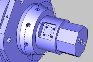

Mill or Mill Turn
Standard Drilling The following images show toolpath
examples of standard drilling for both Mill and Mill Turn jobs.
Mill Standard
Drilling
Mill Turn Standard
Drilling

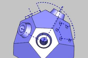

- Multiaxis Drill
Multiaxis drilling is used for multiaxis
machining (more than three axes), in which the tool orientation
may or may not be parallel to the main spindle direction. This
drilling type is also used for Mill Turn jobs, for example, when
drilling holes on the circumference where the tool orientation
does not point to (or cross) the rotation axis of the part (usually
the Z-axis).
Mill or Mill Turn
Multiaxis Drilling The following images show some example
multiaxis toolpath. Note that Multiaxis drilling can also perform
standard drilling.
Mill
Multiaxis Drilling
Mill
Turn Multiaxis Drilling

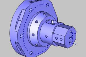

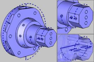

- Cross Drill
Cross drilling is only available
for Mill Turn jobs, which may be called diameter or radial drilling.
This drilling type is used when the tool orientation points directly
to, or crosses, the rotation axis of the part, usually the Z-axis.
Note that the tool orientation must also be perpendicular (at
a right angle) to the rotation axis. On the physical machine,
the tool orientation for cross drill holes is parallel to the
X-axis.
Mill Turn Cross
Drilling The following images show example
cross drilling toolpath. Note that cross drilling does not require
Y-axis capabilities. Drill holes that require Y-axis movement
are not considered cross (radial) drilling and are handled using
Multiaxis drilling.
Mill Turn Cross
Drilling
