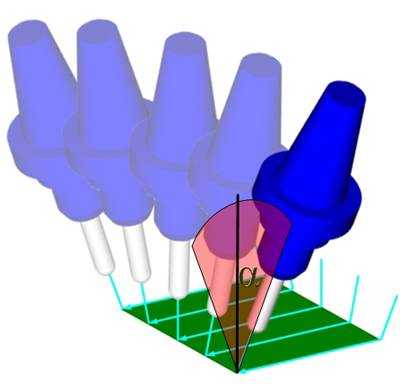

The Gradual Lead Angle Change parameter is an angle offset used with the Lead Angle to Cutting Direction setting. During machining the gradual lead angle change value is divided by the number of cuts into gradual lead angle increments. This new angle increment is added to the lead angle value for every new cut. In the end, the final tool axis orientation is the Lead Angle to Cutting Direction value plus the Gradual Lead Angle Change value. For example, if the lead angle is 5 degrees and the gradual lead angle is 10 degrees, at the beginning of the toolpath the lead angle is 5 degrees. At the end of the toolpath the lead angle is 5 + 10 = 15 degrees. In the middle of the toolpath, the lead angle is 5 + (10 x 0.5) = 10 degrees.
Gradual Lead Angle Change is a special case parameter and it isn't expected to be used widely. For example, a side tilt angle of 40 degrees could be good to machine the top of a blisk (bladed disk) and you might want to reduce it to 10 degrees. The change is applied gradually for each contour. Here collision checking is not used because sometimes you would like to have a very detailed manual control.

  • If the Lead Angle to Cutting Direction is 10 degrees, the first cut has a 10 degree lead angle. The Gradual Lead Angle Change is 35 degrees. With 10 cuts you get an angle increment of 3.5 degrees. The second cut has a total lead angle of 13.5 degrees, the third is 17 degrees and so on. In the end the total lead angle is 45 degrees.
