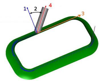

  • In the following image, you can see the surface normal direction in blue (1) and the cutting direction along the part (3). The Lead Angle to Cutting Direction (2) is 45 degrees. The positive angle tilts the tool toward the cutting direction. A negative value tilts the tool away from the cutting direction (the opposite direction of that shown).

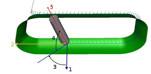

  • This image shows a Lead Angle to Cutting Direction of 45 degrees and Tilt Angle at Side of Cutting Direction of 45 degrees.
