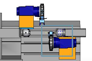

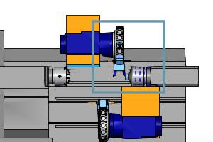

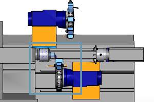

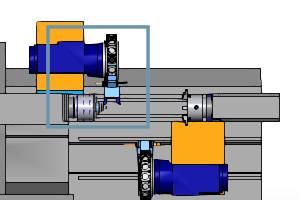

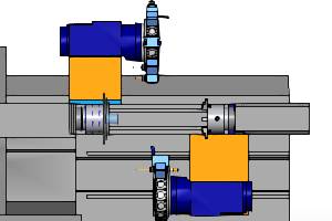

Machine Setups
For this tutorial, all features are created using one of two machine setups: one for the front side and one for the back side of the part. The following images show the location and orientation of the machining origin (work offset) for each setup.
Machine Setup1
Machine Setup2

Part 7) Change the Default Submachine
The next three features that we create use the UT_MS (upper turret, main spindle) submachine, so we want to change the default submachine again. Changing the submachine this time is slightly different than the first time as features already exist, so we are prompted to confirm which features we want to change.
  1. Under Machine Setup - 1, right-click the current submachine name (LT_MS), and click Edit.
  2. Under Submachine Name, click the down arrow, and select UT_MS.
  3. Click OKto update the default submachine.
  4. A message displays to ask whether or not we want to change the submachine in existing features. We only want to change the default submachine for new features, so we click No.
All new machining features we create under Machine Setup - 1 now use the new submachine. The submachine can always be changed in the Posting page of the wizard.

Part 11) Create a Part Transfer Using MDI (Manual Data Input)
For Mill Turn jobs, the MDI page of the wizard allows you to manually define machine movements by combining commands to create lines of code. This is used to handle the movement of machine axes that do not have a specific operation, such as part transfers, cutoff/transfer, parts catchers, steady rests, and tailstocks. We define our part transfer after the grooving operation as it is the last operation we perform on the main spindle before transferring the part to the sub spindle.Be sure to have your chuck jaws oriented properly in your machine definition. For more information on the chuck configuration, see The Chuck Configuration topic.
Note: You can create your own generic MDI files (templates) that are customized for your machine to handle transferring the part from the main spindle to the sub spindle. The expected workflow is to define a process once using MDI, save it to a file, then simply load the saved file and change a few values as needed per job. We do the same for this example using the generic part transfer MDI file that is installed with the software. Contact Support for assistance with MDI features: [email protected] / (727) 489-0003
  1. In the CAM Tree, right-click the last Feature Mill Hole-Blind - 0.2500 feature (that we just created), and click Edit.
    The Lathe Wizard displays for you to make changes to the feature.
  2. In the tree on the left, click MDI.
  3. Notice the Save/Loadgroup under the Task List. Click the (Load) button.
    The Open dialog box should display with the correct location already selected: C:\BobCAD-CAM Data\**Current Version**\Features. If not, navigate to this folder.
  4. Click to select GenericPartTransfer.bcmdiand click Open. (Alternatively, you can double-click the file name to open it.)
    The Load MDI Task dialog displays. This dialog box allows you define exactly what tasks are overwritten with the information from the file.This allows you to load individual tasks from the saved file, but for this example, we use the full replace.
  5. Click OKto replace the entire current Task List with the information stored in the file.
    You can see that only the After Operation task contains any commands (it has the plus sign icon). Click the plus sign to expand the AfterOperation folder and view all the lines that are already defined. All of our commands are under the After Operation task, because our part transfer happens after the grooving operation.
  6. We don't need to make any changes to our generic MDI parameters, but a few of the important commands that you may adjust per job are listed next.

  1. Click Finish to update the feature with the MDI part transfer.
    Our part transfer is now output in the code, and is also visible in simulation (without MDI, in simulation the part just switches spindles without showing the transfer movement).
  2. Simulate the program to view the part transfer.
Part 12) Change the Default Submachine for Machine Setup 2
Now that the part is transferred to the sub spindle, all of our machining features for the second half of the part are created under Machine Setup2, which is set to Work Offset 2. Most of the remaining features use the UT_SS (upper turret, sub spindle) submachine, so we set the default submachine for creating features under Machine Setup 2.
  1. Expand Machine Setup - 2 (if needed), right-click the current submachine name UT_MS, and click Edit.
  2. Change the Submachineto UT_SS (upper turret, subspindle), and click OK.
  3. You can also collapse Machine Setup 1 to minimize the CAM Tree and reduce the need for scrolling.
