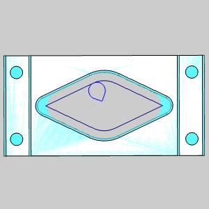

This example explains how to use the Break option in the Edit Toolpath dialog box.On our example part, we have used a solid model to set the stock to a specific shape.In this case, the stock shape shows what the first two operations have left.Due to the size of the rough tool, much more material has been left in the acute angles of our pocket.It is because of this,  it would be beneficial to slow down the feedrate on our finish operation before it engages that extra material.To accomplish this, we will need to break the toolpath elements leading into, and out of, our acute angles.Once this is accomplished, we can adjust the feedrate on the specific portions of toolpath that engage the leftover material, which will be accomplished in another example.This example will have you:

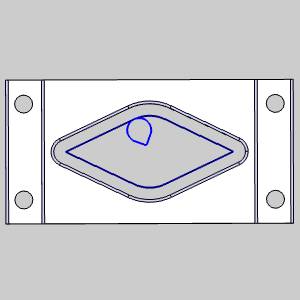

 Take a moment to look at the stock compared to the existing toolpath to see the what we intend to accomplish.
  1. In the CAM Tree, click Stockto view the assigned stock.
    Take a moment to look at the existing stock compared to the existing toolpath to get an idea of where we would like to break our toolpath elements.
  2. In the CAM Tree, click the Pocket operation in the feature to remove focus on the stock and to place focus on the toolpath to be adjusted.

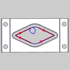

Change Parameters to the Screen Point option.
  1. Select the Screen Point option in the Parameters group.
Part 5) Selecting Toolpath Elements

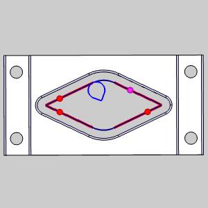

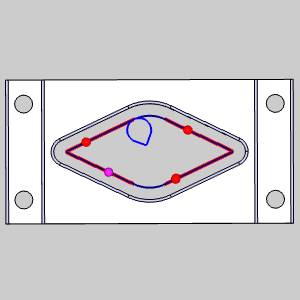

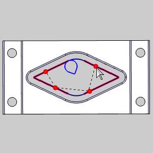

  1. In the graphics area, select the toolpath shown in the images below.
    Notice that as the points are selected, and are added to the Screen Point list, the associated toolpath elements are added to the Selected Toolpath list automatically.

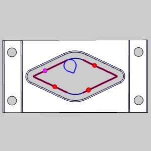

With the toolpath elements selected, we will need to define the distance of the Break Point.
  1. In the Break Point list, select Break Point - 1.
    Break Point - 1 highlights in the graphics area.
  2. Change the Distanceto 70.
  3. In the Break Point list, Select Break Point - 2.
    Break Point -1 adjusts its position in the graphics area and BreakPoint - 2 highlights.
  4. Change the Distanceto 30.
  5. In the Break Point list, Select Break Point - 3.
    Break Point -2 adjusts its position in the graphics area and BreakPoint - 3 highlights.
  6. Change the Distanceto 70.
  7. In the Break Point list, Select Break Point - 4.
    Break Point -3 adjusts its position in the graphics area and BreakPoint - 4 highlights.
  8. Change the Distanceto 30.

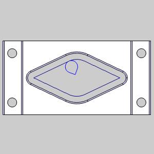

Part 7) Executing the Action
  1. Click Execute.
    Break Point -4 adjusts its position in the graphics area, and the toolpath elements update.
