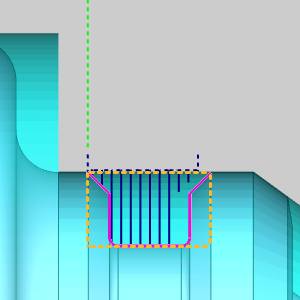

Whether a groove is placed on a part for the fitting of another part, or for an O-ring, and whether the groove is square, round or angular, a groove is an indention on the part. As such, the Groove feature will allow you to create an indention of any size or shape needed on the part.  The Lathe Grooving feature offers two operations, each of which has many variables that can be tailored to your needs.

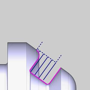

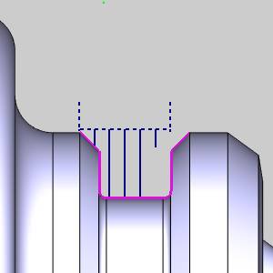

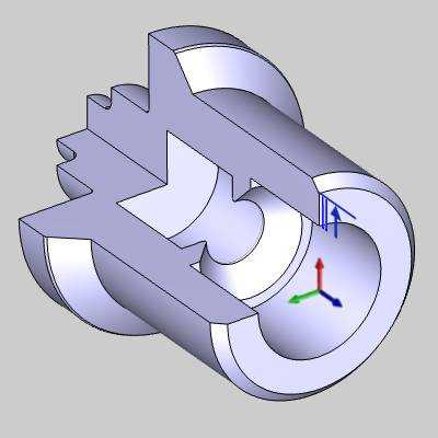

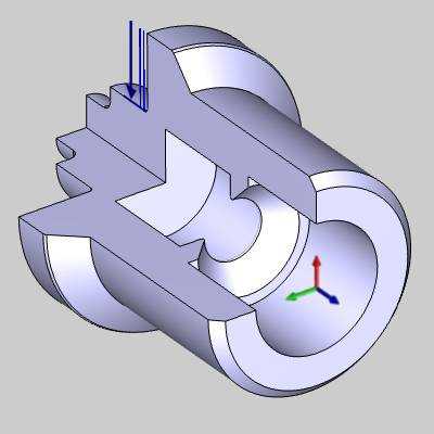

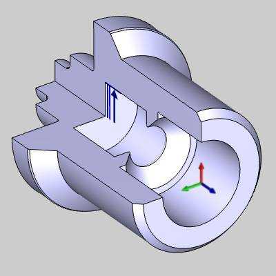

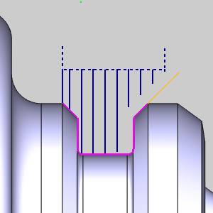

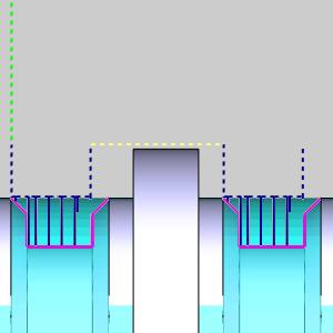

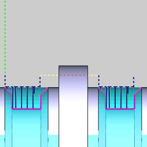

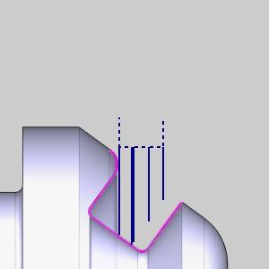

Rapid Plane - is the height at which the tool can rapid safely within a single operation. This value visualized as a dotted line in the toolpath and is an incremental distance above the Top of Feature defined in the Constraints section.
Rapid Crashing
Rapid Lifted
Warning: Rapids that are going through portions of the part are not highlighted in the software but merely go straight through. This rapid has been highlighted for visual aid in this help system.

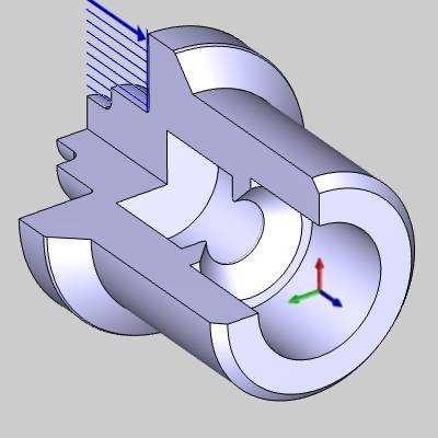

Feature Parameters

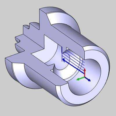

Feature Type

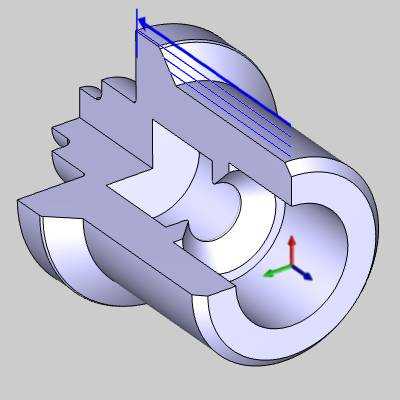

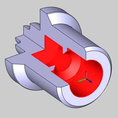

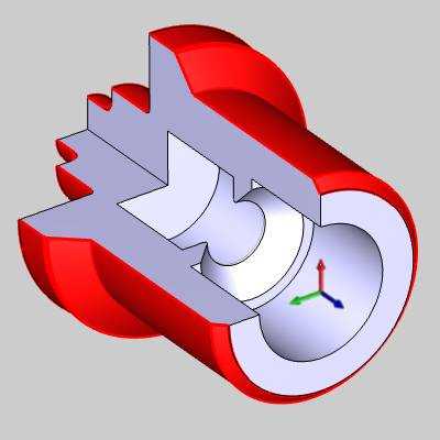

  • OD - Sets the feature to the outer diameter of the part.
  • ID - Sets the feature to the inner diameter of the part.
  • Face - Sets the feature to faces normal to Z+.
  • Back Face - Sets the feature to faces normal to Z-.

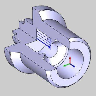

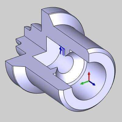

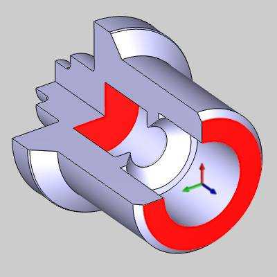

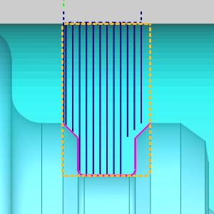

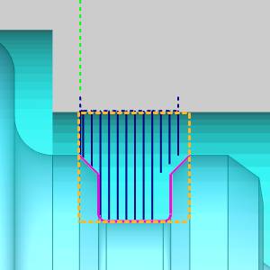

Region - Sets the features default settings for the type of toolpath being used. This will set the default rapids, entry and exits as well as default tool selection and direction of cut.
  • 1 - See examples.
  • 2 - See examples.
OD
OD Region 1
OD Region 2
ID
ID Region 1
ID Region 2
Face
Face Region 1
Face Region 2
Back Face
Back Face Region 1
Back Face Region 2

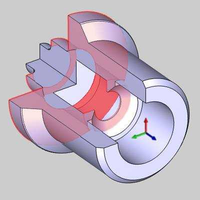

Note: Region selections are not only for particular sections of the part. Even though, for a given situation, a particular region choice will set the feature up to be better suited for the task, the user may adjust the remaining parameters to match their particular needs.

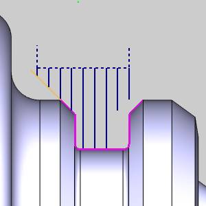

Extension
Extensions allow you to extend the feature geometry without the need to create additional CAD geometry. The extension will be added or subtracted along the chain of entities.
- No extension will be added to the feature geometry.
- Will allow you to define an extension to the feature geometry.
Extension Off
Extension Start On
Extension End On
Start - is the first of the selected chain of entities.
  • Distance- sets the amount of extension added to the tangent direction of the chain.
    • Angle - While cleared the extension will added to the geometry to the tangent direction.
      Angle- Select this check box to set the extension at a specified angle.
      • Relative to geometry - Select this check box to set the angle of the extension relative to the tangency of the first entity.
        Relative to geometry - While cleared the angle of the extension will be absolute.
End - is the last of the selected chain of entities.
  • Distance - sets the amount of extension added to the tangent direction of the chain.
      • Relative to geometry - Select this check box to set the angle of the extension relative to the tangency of the last entity.
