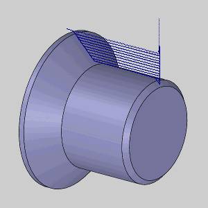

This topic will describe the Machining Strategy page and the options found in it. This topic will also describe how to set up a machining strategy and provide a link to the next topic.
The Machining Strategy page
Machining Strategy
Template
Current Operations |
Available Operations |
Rough Basic Finish |
Rough Pattern Repeat Basic Finish
The Templates provide predefined groups of operations that can be applied to a feature. Select a template to populate the Current Operations list. (You can customize the DMS Defaults to define the default operations for each template.)
The Available Operations list displays all operations that exist for the selected feature type. After selecting a template, you can use the Available Operations to ad operations to the Current Operations.
Finally, you can reorder and/or remove operations from Current Operations to define all of the operations for the feature. (You can modify this list at any time, for example, when editing the feature.)
