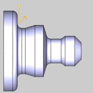

The Patterns page gives you control over the pattern of the cut, how that pattern is sorted, and the compensation that will be used to complete the operation.
Pattern

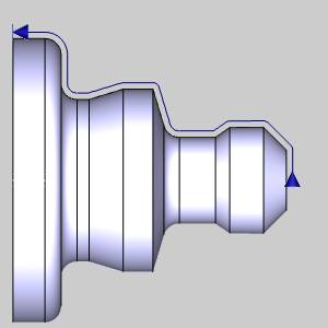

Continuous - sets the finishing pass to a single pass along the geometry.

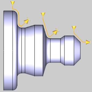

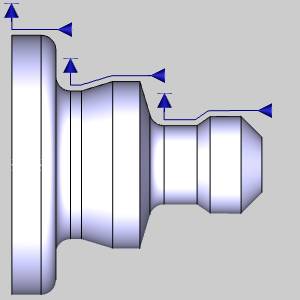

Alternate - breaks the finishing pass into separate groups defined by either vertical faces, turned diameters, or a combination of the two.

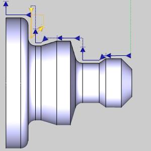

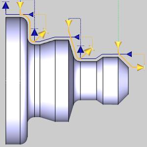

Both - will Face Vertical, and Turn Diameter with opposing direction of cuts.

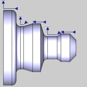

Face Vertical Only - will only cut vertical walls.
Turn Diameter Only - will only cut geometry running parallel to the center of rotation.
Include angled walls - will allow for geometries that are not perfectly vertical or horizontal to be cut as well. This check box is selected by default. See the table below to see how clearing this check box can affect the various selected options.
Turn Diameter Only
Face Vertical Only Both
