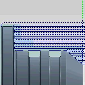

Pattern
The Pattern allows you to select how the passes are laid down.

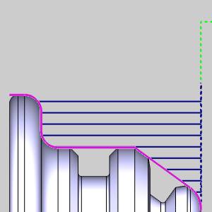

Standard - Each
pass will be parallel to the center of rotation.

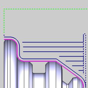

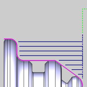

Offset - Each pass
will be an offset copy of the selected geometry trimmed to the feature
constraints.
| Standard | Offset |

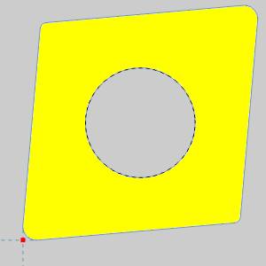

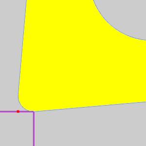

Each tool has a theoretical point placed on it as seen in red in the animation below. In the case of tools with a radius of any size, this point is not actually on the tool, but on the horizontal and vertical intersections of the radius. It is this point that the toolpath plots out. When compensation is used, it is designed to place the actual tool and not just its theoretical point on the geometry. This can be accomplished with System Compensation, Machine Compensation, or a combination of the two.
System Compensation
Off - the selected geometry is used as the program path; Machine Compensation should be used.
On with Collision Detection - the system compensates for the tool nose radius and the insert geometry and avoids any detected collisions.
Use Tool Holder - a collision check is done on the holder, and the toolpath is adjusted to ensure the tool holder does not collide with the geometry. -
On without Collision Detection - the system compensates for the tool nose radius and the insert geometry without checking for collisions.
| System Compensation: | |||
Theoretical Point |
Off |
On with Collision Detection |
On without Collision Detection |

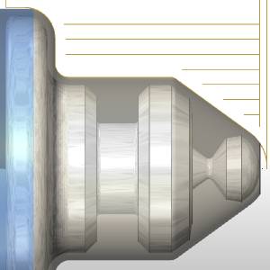

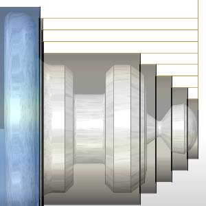

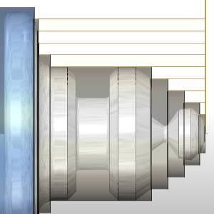

Z
- sets the amount left in the Z direction for the finish.

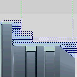

No Allowance |
Finish Allowance |
Rough & Finish |
No Allowance Simulation |
Finish Allowance Simulation |
Rough & Finish Simulation |
*Steps can also be eliminated with the Overlap options below. |

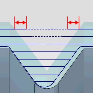

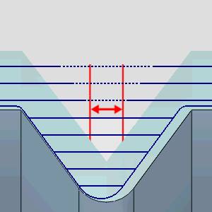

Overlap
The Overlap options allow you to create an additional move prior to the link to the next pass. This link will track back up the geometry in order to eliminate stair steps as seen in the images above. Overlap is controlled with either, To Previous Cut, No Overlap, or Custom Distance.
To Previous Cut - automatically
tracks back up the geometry the distance of the selected depth of cut.
No Overlap - does not track back
up the geometry at all.
Custom Distance - Allows you to
enter a custom distance value. This value is a vertical distance. Entering
the same value that has been entered for the depth of cut will track back
to the last cut exactly.

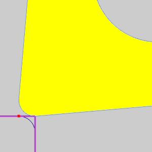

Corner Type
Round - keeps the specified tool
geometry in contact with the geometry at all times.
Sharp - allows the tool to move
off the geometry in order to line up with the next move on the following
entity. This method eliminates the rounding over of the tool.
Theoretical Point on Tool |
Rounded Corner |
Sharp Corner |
