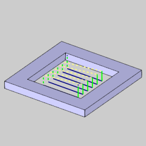

  • Standard Pocket - creates a pocket with the specified patten. Standard pockets do not support open pockets.

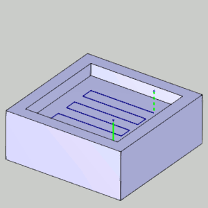

    • Parallel - creates a pattern of parallel cuts where the tool feeds in both directions. With this pattern, you can select either No Profile, Profile After, or Profile Before, from the Final Contour group.

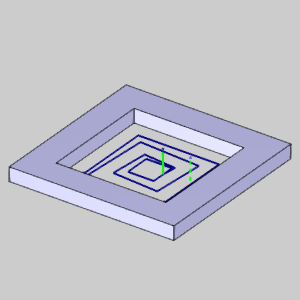

    • Offset Pocket Out - creates a pocket pattern which continually offsets the inner shape of the pocket and creates the toolpath from the inside-out.
    • Offset Pocket In - creates a pocket pattern which continually offsets the outer shape of the pocket and creates the toolpath from the outside-in.

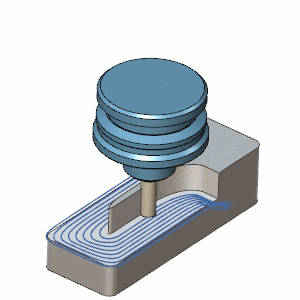

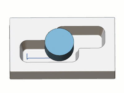

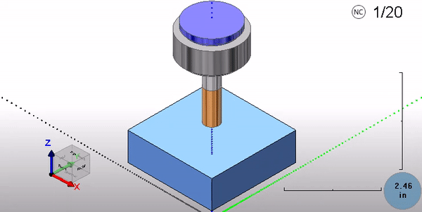

    • Adaptive Roughing - creates a high-speed machining operation with automatic tool engagement settings. When this option is selected, the Minimal Curvature Radius is added to the Parameters group in this dialog box. In addition, the Link Clearance is added to the Finish group in the Parameters page of the wizard.

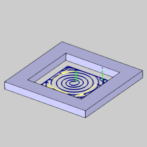

  • Use Spiral for Circular Pockets - Spiral pockets give the user the ability to create spiral toolpath instead of the standard offset toolpath for circular pockets. This option is not available when using the Morph Spiral, or Adaptive Roughing patterns.
    Select the check box to a override the previously selected pattern in favor of a spiral pocketing method on circular pockets.
    While  the check box remains unselected, the currently selected pattern will be applied to all geometry, including circles.
    Offset
    Spiral
Final Contour - This group becomes available when the Parallel pattern is selected.
  • No Profile - No finish pass is calculated.
  • Profile After - A finish pass is added to remove the material from the pocket after the pattern is applied.
  • Profile Before - A finish pass is added to remove the material from the pocket before the pattern is applied. This option is not available when using the Advanced Pocket.

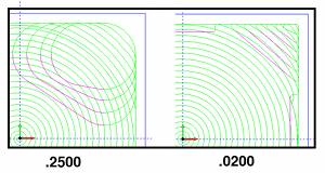

Sharp Corner - This group becomes available when the Offset patterns are selected for Advanced Pockets.
Sharp Corner Sharp Corner
  • Open Convex Corners Only - applies the Sharp Corners only to the open areas of the pockets. This can be helpful to avoid roll overs which may interfere with nearby part walls which should not be contacted with the tool.
  • All Convex Corners - applies Sharp Corners to all areas of the pocket, whether opened or closed.
    • Smooth Radius in % of Stepover - is the value for the amount of smoothing measured from the original contour and the rounded corner.

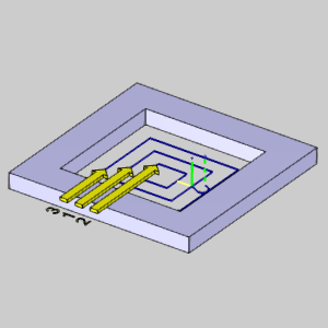

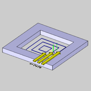

  • One Way (Advanced Pocket)
    Select the check box to define a one-way machining for the Advanced Pocket. This enables the Climb Mill and Conventional Mill cutting options.
    • Climb Mill - the tool travels in a counter clockwise direction along the inside shapes of the model and travels in a clockwise direction along the outside edges of the model.
    • Conventional Mill- the tool travel in a clockwise direction along the outside edges of the model.
    Clear the check box to use an offset pocketing strategy.
    One Way One Way

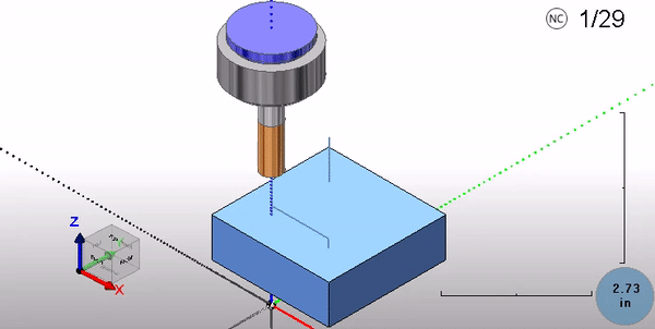

Rest Roughing
  • Rest Roughing
    Rest Roughing- With this check box cleared, the pocket will be handled normally.
    Rest Roughing - When the Advanced Pocket pattern is selected, Rest Roughing calculates the toolpath to remove all the non-machined areas remaining from the previous roughing tool. It machines only those areas that are left behind by the (larger) previous tool. In Rest Roughing toolpaths you normally use a smaller step down (as the cutter size reduces) than the cutter used for the previous roughing toolpath.
    Rest Roughing Rest Roughing

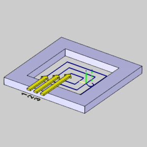

This group is available when the Cut Pattern on the Patterns page is set to Offset Out, Offset In, or Morph Spiral.
  • Avoid Air Machining
    - With the check box cleared, the stepover will be continued over the entire part. This can result in cuts being made to areas which already have stock removed.
    - With the check box selected, toolpath will be terminated in areas which have already been cleared of stock.
    Avoid Air Machining Avoid Air Machining

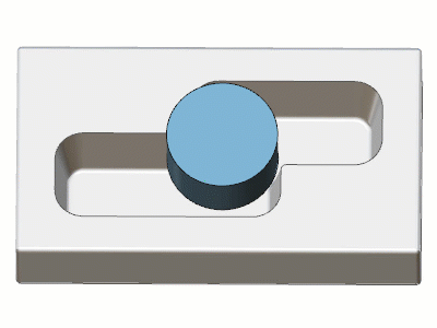

  • Remove Corner Pegs
    - Clear the check box to turn off Remove Corner Pegs.
    - Select the check box to add extra tool movement in corners, removing the rest material; for use when a stepover greater than 50 percent results in small pegs of material remaining in the corners. With this check box selected, you will be able choose between the following three options.
    • Line-Arc-Line - removes the corner pegs with an arc between two lines as seen in the animation below.
      • Corner Peg Height in % of Tool Diameter - sets the size of the corner peg based on a percentage of the tool size in use.
    • Arc - removes the corner pegs with a single looping arc motion as seen in the animation below.
    • Line - removes the corner pegs by moving away from, and back to the toolpath with a straight line as seen in the image below.

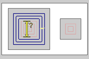

Stepover
  • Dependent Desired Stepover - This feature lets you avoid the hard coded dependency between the maximum and desired stepovers in the adaptive roughing pattern. The desired stepover parameter can take any value which is less than the maximum one. The hard coded value is 1.25 x maximum stepover.
    - With this check box cleared, you can list a Desired Stepover, which must be lower than the previously specified (Maximum) Stepover.
    - With the check box selected, the Desired Stepover will be set so the specified (Maximum) Stepover will be 1.25 times greater.
    Dependent Desired Stepover Dependent Desired Stepover
