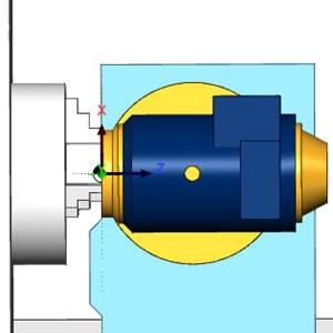

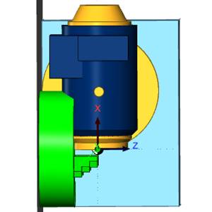

The rotation angle that you use for a milling spindle is based on where the machine controller defines zero degrees. The two most common zero degree orientations for a milling spindle on the machine are shown next.
Milling Spindle Zero Degree Orientation (Z Axis) |
Milling Spindle Zero Degree Orientation (X Axis) |
