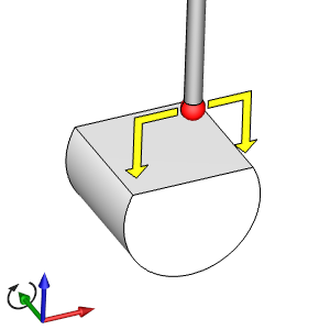

This cycle measures two points along the X Axis of a planar surface in order to find the angle of the surface along the XZ Plane and make the necessary corrections to the rotary axis to bring the angle to zero and thus ensure a flat surface. This can also be used to check tolerance rather than to correct the rotary axis. This cycle can utilize the following geometry inputs:

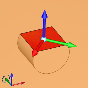

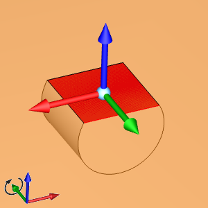

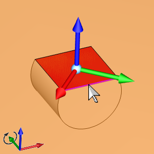

When setting up the index system for the 4th Axis cycles, it is important to keep in mind the alignment along the X, and Y Axes. If the part is aligned with these, setting up the index system can be done by simply selecting the surface. However, if the part is not aligned properly, as in this example, it is important to create a UCS system that is aligned properly so the Index System can be created from it.
- In the UCS Manager, right-click and select Add New UCS.
The Create UCS dialog opens in the Data Entry Manager. - At the top of the Create UCS dialog, in the UCS Name text field, type Index System to set the name of the new UCS.
- In the Creation Option group select the Planar Face option.

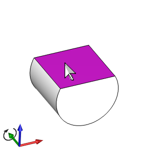

- In the graphics area select the Planar Face of the part.
The face is added to the Selected Geometry list, and the UCS preview appears in the graphics area.

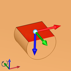

- In the User Coordinate System section, select the Modify check box.
- In the Coordinate System group, click in the list box for X Direction, and click the edge of the part to align the X Axis with.
The UCS updates its alignment.
- Next to X Direction, click the Reverse Direction button to update the direction of the X Axis.

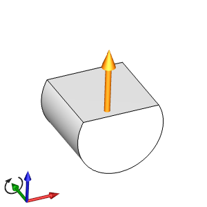

The Z Axis of the UCS is updated. - Next to Z Direction, click the Reverse Direction button to update the direction of the Z Axis.
The Z Axis of the UCS is updated. - Click OK.
The UCS is added to the UCS Manager. - Click Cancel.
The dialog is closed.

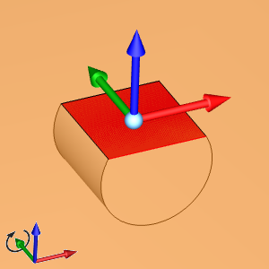

Part 2) Setting up the Index System
With our UCS set up properly, we can now use that to align our Index System properly.

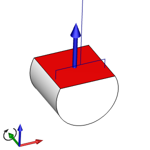

- In the CAM Tree, locate the desired Machine Setup for the Probing cycle, right-click the Machine Setup, hover over Addition Functions and select Add Index from the flyout.

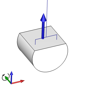

The Index System Selection dialog launches in the Data Entry Manager. - At the top of the dialog, select Select UCS.
A drop down list of the current UCS's becomes available, and the index preview is shown based on the currently selected UCS.
- Select our newly created Index System UCS from the list.
The origin of the index system updates. - Click OK.

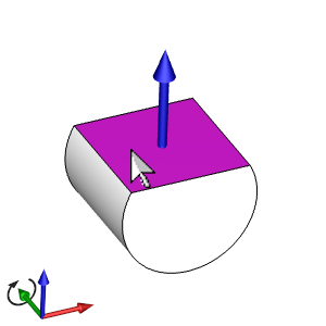

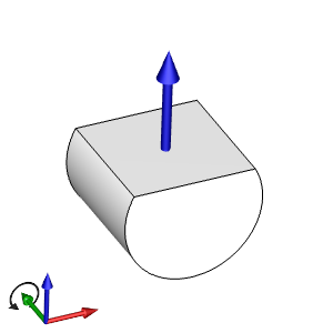

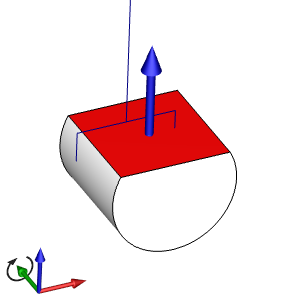

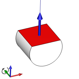

By default the Selected Geometry list is given focus to allow you to select geometry from the graphics area. - Select the planar surface whose normal is parallel with Z.
Since our current geometry works for a Z Single Surface cycle, that is the cycle that is currently selected for us.
Part 7) Updating the cycle

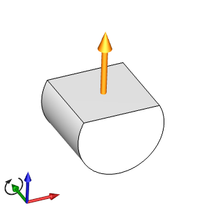

In this case, the geometry we have chosen could be interpreted as a Z Single Surface cycle. Had we chosen the planar surfaces themselves instead of the edges, the proper cycle would be selected already.However, since we did not, we will need to update the currently selected cycle.
- At the top of the Cycles section click the drop down list and select 4th Axis Measurement (B Axis) from the list.

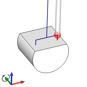

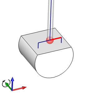

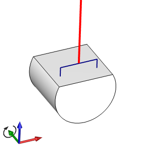

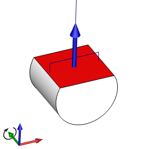

- In the Initial Position group, update the X value by adding -0.25 to the end, and pressing Tab.
However, notice how the end positions are tied to the initial position and one of our contact points is now off of the part. Technically we could correct this by adjusting the Width value in the Parameters section, between the two points, but we will set that value back as it was. - In the Initial Position group, update the X value by adding +0.25 to the end, and pressing Tab.
The value and the toolpath update to put the toolpath back as it was.

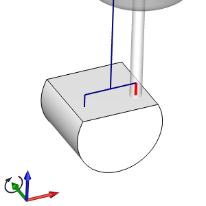

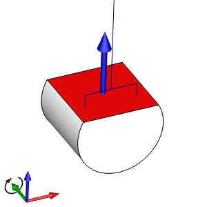

- In the Initial Position group, update the Y value by adding -0.25 to the end, and pressing Tab.
Part 9) Updating the Parameters section
The Parameters section for this cycle consists of the Z Measurement Height, the Width and the Update Work Offset value. In this case we only want to adjust the distance between where the probe will contact the surface. The Update Work Offset value can be used as needed.
- In the Parameters section, update the Width value by adding -0.25 to the value and pressing Tab.
The toolpath width of the contact points is updated.

Part 11) Backploting the result

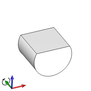

- Click Next three times to view the probe movements.
