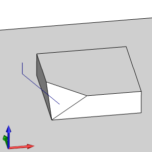

The Angled Surface in XYZ Plane Cycle

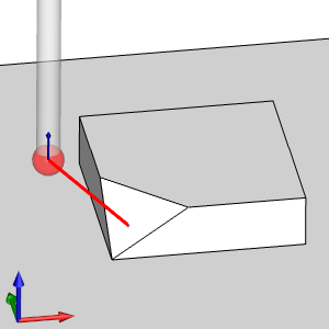

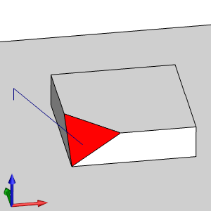

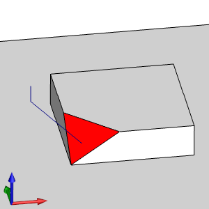

This cycle measures a planar surface whose normal is not parallel to the X, Y, or Z Axes. This cycle can utilize the following geometry inputs:
- Planar surface face whose normal is neither parallel to the X Axis, the Y Axis, nor the Z Axis.

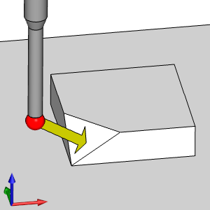

- Distance - determines the distance from the surface at which the probe will begin the cycle.
- Output Value Option
- With this check box cleared, the output will be the probe trigger points with no corrections.
- With this check box selected, you can adjust output values in variables #124, #125 and #126. It does not change the way cycle movements are performed as X,Y offsets are always considered.Choose from: - 0 - Spindle centre-line adjust. This is used for stylus XY calibration offset error correction only.
- 1 - Spindle center-line adjust. This is used for stylus XY calibration offset error correction and Z height adjustment by the ball radius value (i.e. the center of the ball).
- 2 - Surface contact point adjust along the approach vector. This is used for stylus XY calibration offset error correction and radius correction along the XYZ approach vector.

- Click the Parameters tab.

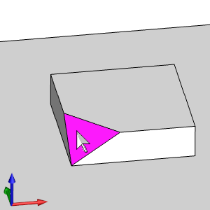

By default the Selected Geometry list is given focus to allow you to select geometry from the graphics area. - Select a planar surface whose normal is parallel with the X, Y, or Z Axes.

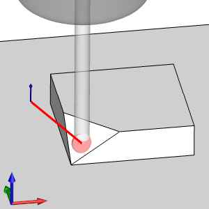

Part 5) Updating the Parameters section

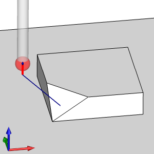

The Parameters section for this cycle consists of the Z Measurement Height, X and Y values, and the Distance value. In this case we do not really need to adjust the height at which the probe will make contact. The X and Y values could be adjusted to update the point at which the probe will make contact, but will be left as they are for this example. For this example will update the Distance.
- In the Parameters group, update the Distance value by adding -0.5 to the end, and pressing Tab.

Part 7) Backploting the result
The Backplot dialog launches. - Click Next to view the probe movements.
- Click Close.
