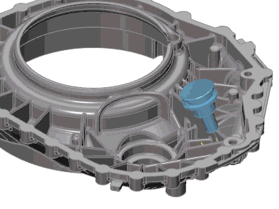

Display Focus
The simulation focus determines how the tool, machine, and material/workpiece display using one of the following options.
Tool Focus(T)
- simulates the program with the tool and workpiece visible, with
the tool remaining stationary.
Workpiece Focus (W) - simulates
the program with the tool and workpiece visible, with the workpiece remaining
stationary.
Machine Focus(M)
- simulates the program showing the kinematic motion of all machine
elements.
