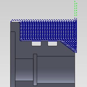

Part 3) Facing the Part
For most every Turning Job, you will need to face off the stock.By selecting a Lathe End Face feature, we will automatically create toolpath up to the machine zero without the need to select geometry.The only time geometry will need to be selected for the Lathe End Face feature is if the desired toolpath needs to end before, or, continue beyond the machine zero.
Add the Feature
  1. In the CAM Tree, right-click Machine Setup - 1 and selectLathe End Face.
    The Lathe End Face feature launches with the Geometry Selection pageactive.Since our target geometry is already at the machine zero, we do not need to select geometry.
  2. Click Next>>to continue to the Feature page.
Create Feature Extensions
  1. Select the Extensioncheck box and, in the End Distancebox, enter a value of 0.1000.
Select a Tool
    The Tool Crib launches.
    The Tool Library launches.
  3. Select tool number 263to highlight the CNMG - 3/64RAD - ROUGH TURNINGtool.
  4. Click OKto exit the Tool Library and return to the Tool Crib.
  5. Click OKto exit the Tool Crib and return to the Lathe Wizard.
  6. Select Parameters.
Adjust Parameters and Compute
Tip: In this case, we use our roughing tool to rough and finish the face.Since we use the same tool for the rough and finish, the need to create a separate finish operation is avoided by utilizing the Rough Allowance.The RoughAllowance ceases the roughing operation at the values entered and creates an additional semifinish pass up to the Finish Allowance specified next.
  1. In the Finish Allowancegroup, change both the Z and, X value to 0.0000.

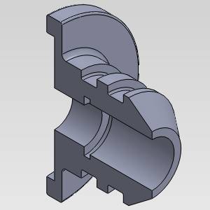

Part 4) Turning the Part
In this step we create a Lathe Turning feature, assign Rough and BasicFinish operations, and define the parameters of those operations.
  1. In the CAM Tree, right-click Machine Setup - 1 and selectLathe Turning.
  2. Click SelectGeometry.
    The Lathe Wizard hides and the Selection Manager opens to allow geometry selection.
  3. area To select the entire model as our geometry:
    1. Click OK to confirm the geometry selection and return to the Lathe Wizard.
  1. In the Lathe Wizard, click Next>>to continue to the Feature page.
Adjust Feature Settings
  1. In order to avoid cutting the grooves with these operations, select the Remove Primary Undercut check box in the Undercutgroup.
  2. To continue beyond the selected geometry, select the check box for Extensionand enter a value of 0.2500into the End Distance box.
  3. Click Next>>to continue to the Machining Strategypage.
Set the Machining Strategy
  1. Select Rough / Finish in the Machining Strategy section of the Machining Strategy page to assign a Rough and BasicFinish operation to the feature.

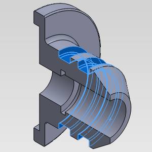

Part 5) Grooving the OD
In this case, we have two grooves that need to be completed on the OD of the part and one groove on the ID.Right now we will focus on the two OD grooves.
  1. Right-click Machine Setup - 1 in the CAM Tree and selectLathe Groove.
    The Lathe Wizard launches.
  2. Click Select Geometry.

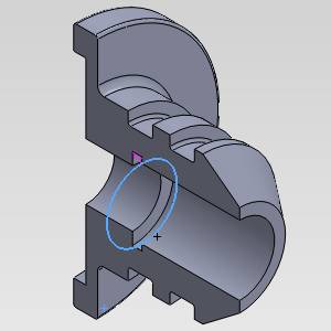

  3. In the graphics area:
    1. Click OK.
  1. Click Next>>to continue to the Feature page.
  1. In the Feature page, under the Constraintssection, select From Geometry.
  2. Select Groove.
  3. Click Tool Crib.
    The Tool Library Launches.
  5. Select tool number 281to highlight the 1/8 WIDE - 1/64RAD - OD GROOVE tool.
  6. Click OK.
  8. Select Patterns.
  2. Select the check box for Rough Allowance and adjust the Xvalue to 0.0050.
  3. Under Semifinish Pattern, set the Overlapvalue to 0.0050 to ensure that each of the downward semifinish cuts will go slightly beyond center.
  5. Click Compute.

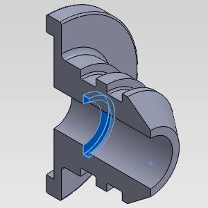

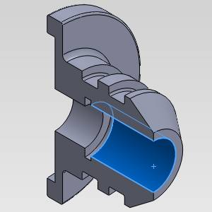

Part 6) Boring the ID
Now that we have completed the outer diameter of the part, we need to begin working on the inner diameter.The first thing we will work on is a basic Rough and Finish.
    1. Press confirm the geometry selection.
Set Feature Settings
  1. In the Feature page under Material Approach, set the Rapid Planeto 0.0500.
  2. Under Feature Parameters, select IDfrom the Feature Type list to set the orientation of the feature.
  3. Under Undercut,select the Remove Primary Undercutcheck box so that our rough does not try to complete the ID groove feature.
  4. Select the check box for Extensionand enter a value of 0.4500into the End Distance box.
  5. Select Rough.
Select a Tool
  1. Click Tool Crib.
  3. Select tool number 500to highlight the CNMG - 1/32 RAD .750 BORING BARtool.
  5. In the Tool Crib:
  1. In the Parameters page, select the checkbox for Rough Allowance and adjust the Z value to 0.0010.
Tip: In this case, our stock has already been faced off.In order to avoid unnecessary feed movement, we use the Trim to Stock option to set trim the toolpath to the Operation Stock.
  1. Select Leads.
  2. Click Compute.

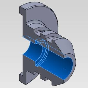

Part 7) Grooving the ID
  1. In the Feature page, under Material Approach, set the Rapid Planeto 0.0500.
  3. Under Constraints,select Custom and then clickPick since the material has already been removed for a portion of this geometry, we can change where the toolpath begins.
  4. Highlight the
  5. top edge of the smaller wall of the groove, connecting entity to the right of the groove, and left-click.
  6. Confirm the geometry selection.
    The Lathe Wizard returns.
  7. Select Groove.

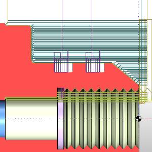

  1. In the Feature page, under Feature Parameters select IDfrom the Feature Type list.
    1. In the Start Distance box enter a value of 0.3750.
    2. In the End Distance box enter a value of 0.0300.
  3. Select Thread.
Select a Tool
  1. Click Tool Crib.
  3. Select tool number 505to highlight the 60 DEG - LAY DOWN - ID THREAD .IC  tool.
  4. click OK.
    2. Click OK.
Set Parameters and Compute
  1. Under Parameters,set Threads Per Unit to 5.0000.
  2. Select the check box for Overrideand set Thread Height to 0.1190.
Important: The ThreadHeight that is calculated in BobCAD-CAM is the theoretical sharp height.Depending on the thread being cut, you may need to adjust this value.
  1. Click Compute.
