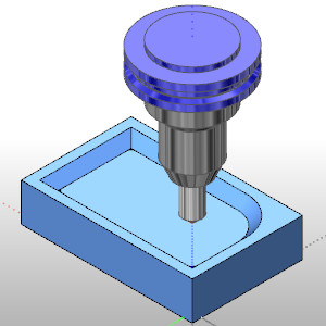

V-Carve Pocketing
The V-Carve feature type is generally used to engrave text, arcs, lines and splines in a 3-dimensional form with 3-axis tool motion, with pocketing of open spaces in the selected profiles if necessary. There are two V-Carve operation types, Tapered Pocketing and V-Carve Finishing (engraving). This example uses the both operations, one to perform the pocketing with an endmill, and the second to cut a tapered wall around the pocket.
Pocketing a shape with V-CARVE example:

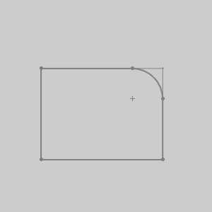

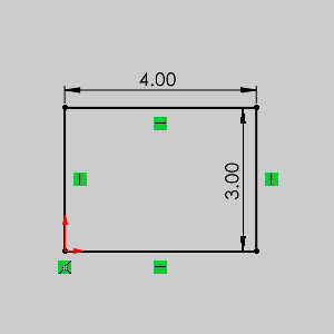

Part 2) Create the Rectangle
- Right-click the Front Plane and select Sketch.
- Choose Tools > Sketch Entities > Corner Rectangle.
- Starting at the origin, create a rectangle with values X = 4 and Y = 3 and click OK.

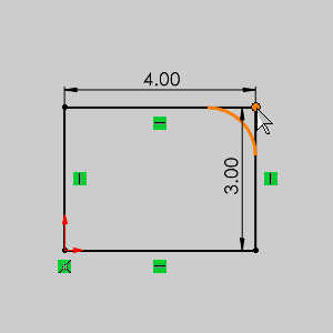

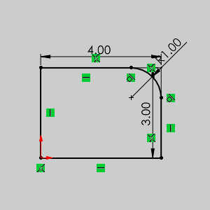

Part 3) Create the Fillet
- Choose Tools > Sketch Tools > Fillet...
- Set the Parameters to 1.0000.
- Select the Vertex at the top-right and click OK.
- Exit the sketch.

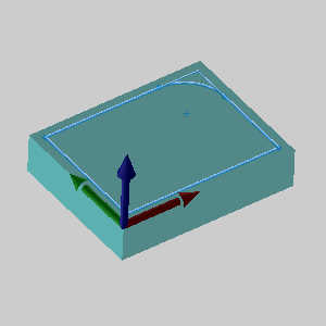

Part 5) Create the Stock
- With Rectangular selected, the software automatically creates a bounding stock for the text in the graphics area.
- In the Offset group, add a 0.2500 offset for -X, +X, -Y, and +Y.
- Click
to go to the Machine Setup.

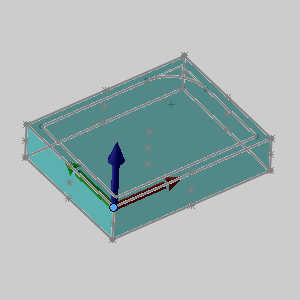

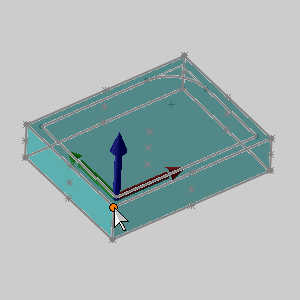

Part 6) Set the Machine Setup and Work Offset
- Select the following vertex as the origin.
- In the Work Offset group, set the Z value to .000.
- Click OK.

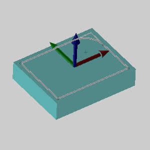

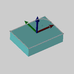

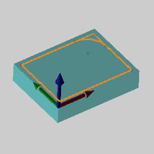

Part 7) Create the Feature
- In the CAM Tree, right-clickMachine Setup, and click Mill V-Carve.
- In the Mill V-Carve Wizard,click the Select Geometry button.
The Mill V-Carve Wizard disappears, allowing you to select geometry from the graphics area. - In the Feature Manager Design Tree, select the sketch.
- Click OK.
The Mill V-Carve Wizard returns. - Click Next>> to go the Feature page.
- In the Feature Parameters group, change the Total Depth to .
- Click Next>> to go the Machining Strategy page.
- In the Tree on the left of the wizard, click
Machining Strategy to jump to that page. - Under Available Operations,with Tapered Pocketing selected, click the left arrow button,
,to add the operation to the Current Operations list. - Under Current Operations, click the up arrow button,
, to move the Tapered Pocketing operation to the top of the list. - Click Next>> to update the tree with the new operations.

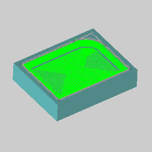

- At the bottom of the wizard, click Compute.
- To view the toolpath simulation, right-click Milling Job and click Simulation.For more information on using simulation, view Getting Started with Simulation.
