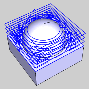

Z Level Rough
Z Level Finish
Planar
Spiral
Radial
Plunge Rough

  1. The Templates provide predefined groups of operations that can be applied to a feature. Select a template to populate the Current Operations list. (You can customize the DMS Defaults to define the default operations for each template.)
  1. The Available Operations list displays all operations that exist for the selected feature type. After selecting a template, you can use the Available Operations to add operations to the Current Operations.
  1. Finally, you can reorder and/or remove operations from Current Operations to define all of the operations for the feature. (You can modify this list at any time, for example, when editing the feature.)
