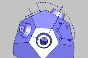

    Multiaxis Drill
    Multiaxis drilling is used for multiaxis machining (more than three axes), in which the tool orientation may or may not be parallel to the main spindle direction. This drilling type is also used for Mill Turn jobs, for example, when drilling holes on the circumference where the tool orientation does not point to (or cross) the rotation axis of the part (usually the Z-axis).
    Mill or Mill Turn Multiaxis Drilling
    The following images show some example multiaxis toolpath. Note that Multiaxis drilling can also perform standard drilling.

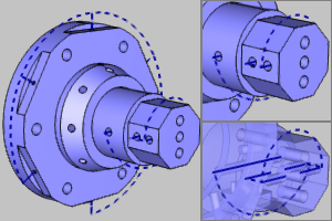

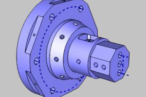

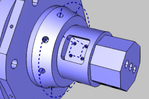

    Cross Drill
    Cross drilling is only available for Mill Turn jobs, which may be called diameter or radial drilling. This drilling type is used when the tool orientation points directly to, or crosses, the rotation axis of the part, usually the Z-axis. Note that the tool orientation must also be perpendicular (at a right angle) to the rotation axis. On the physical machine, the tool orientation for cross drill holes is parallel to the X-axis.
    Mill Turn Cross Drilling
    The following images show example cross drilling toolpath. Note that cross drilling does not require Y-axis capabilities. Drill holes that require Y-axis movement are not considered cross (radial) drilling and are handled using Multiaxis drilling.

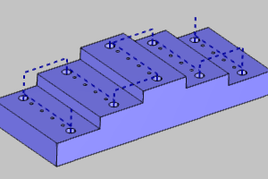

    Supported Geometry Types
    When selecting geometry for drilling features, you can select whole solids, points, arcs, lines, surface edges, or cylindrical surfaces. All drilling types support all of these geometry selections, with one exception that points cannot be selected for multiaxis drilling.
    Drill Holes Example Part
    Supported Geometry Selections
    The following images show all supported geometry selections that can be used to for the example part.
