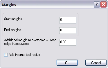

For use with Full, Start and End at Exact Edges or Determined by Number of Cuts, the cuts start or end at the exact edge of the drive face. The toolpath on the surface edge now has a defined position. With this position it is possible to define a certain margin from the surface edge for the first cut and the last cut.
The Dialog Box Parameters
ClosedView the Margins dialog box
  • Start margins - sets the margin used at the first edge or curve.
  • End margins - sets the margin used at the last edge or curve.
  • Additional Margin to Overcome Surface Edge Inaccuracies - is used to help compensate for system tolerances. This value is added to the margin. If you set this option to one and the margin to four, then the toolpath is generated 5 units from the edge.
  • Add Internal Tool Radius
Select the check box to add the tool radius value to the other margin values.

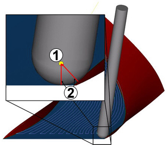

  • Morph Between Two Surfaces
The area type has to be set to Full, Start and End at Exact Surface Edge because the distance between the margin and the first cut depends on the exact position of the surface edge. You see in the next image why it is so important. In this impeller example you have an inlaying edge. The toolpath has to fit in that edge to avoid a gouge. When you set a margin equal to the tool radius (1), the tool is kept that distance from floor face and blade face (2). Always use a Margin that is at least the same as the tool radius.
