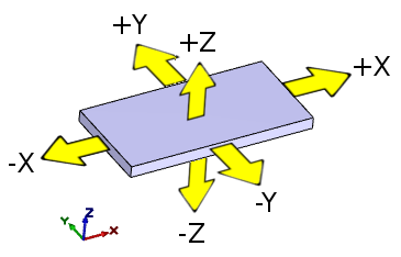

This group is used to extend or trim the stock geometry along any of the Cartesian axes. You can type positive or negative values to extend or trim the stock respectively in each direction.
Offset Diagram
  • -X - the negative X-axis direction.
  • +X - the positive X-axis direction.
  • -Y - the negative Y-axis direction.
  • +Y - the positive Y-axis direction.
  • -Z - the negative Z-axis direction.
  • +Z - the positive Z-axis direction.

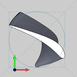

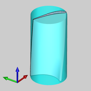

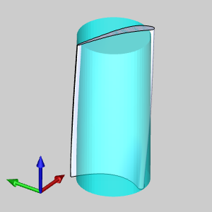

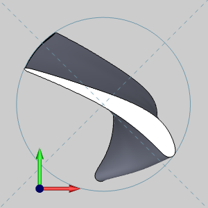

  • Bounding Box - sets the stock by using the extents of the selected Geometry Option to create a bounding box that will center the stock. The diameter of the stock is then equal to the longest side of the rectangular bounding box.
Note: While the default Bounding Box option works fine in most cases, the image above shows a scenario in which it fails to enclose all of the geometry in the cylindrical stock. The Bounding Box  is shown with dotted lines. Notice that the Bounding Box itself encloses the geometry, while the arc that is created fails to.
  • Bounding Cylinder -  uses an algorithm to calculate the smallest possible cylinder to enclose the geometry selected with the Geometry Option to create stock.

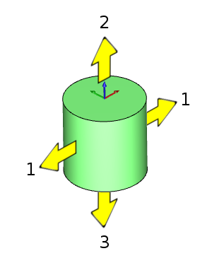

This group is used to extend or trim the cylindrical stock geometry. You can type positive or negative values to extend or trim the stock respectively in three directions.
Offset Diagram
  • SWCylDiamOffIcon.png Diameter Offset (1) - offsets the stock diameter.
  • SWCylStartFaceOffIcon.png Start Face Offset (2) - offsets the top face (where the stock origin displays).
  • SWCylEndFaceOffIcon.png End Face Offset (3) - offsets the bottom face or the face opposite from the stock origin.
