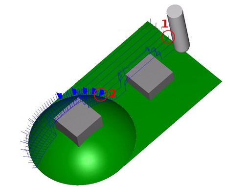

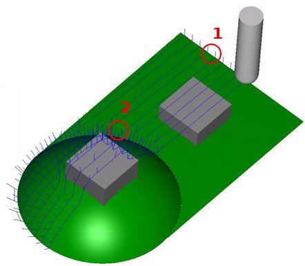

For flat surfaces, toolpath points are only generated at the edges. Because there are no points between the edges, the standard gouge check wouldn't show a gouge. When setting a Maximum distance value, this option may not be necessary.
Gouge Check Between Positions
On the flat part of this example no toolpath points lie between the edges. The tool gouges with the grey check surface. On the round part, many toolpath points exist. For this part, the gouge checking works even without using Gouge Check Between Positions.
On the flat part of this example, no toolpath points lie between the edges. When usingGouge Check Between Positionsthe system finds the grey check surface and avoids the gouge. On the round part of this example, many toolpath points exists. Gouge checking works even without usingGouge Check Between Positions.

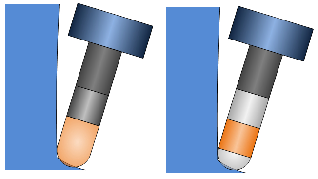

Check Tip Radius
Check Tip Radius - can be used with gouge check option Tilt Tool Away. This option deactivates gouge checking for the flute radius of a ball mill or bull mill.
Select the check box to gouge check the tool
tip radius.
Clear
the check box to turn off gouge checking of the tool tip radius. This
is used for example, if you want to ignore a gouging tool tip for
a specific scenario.
In the next image on the left the tool tilts away from the wall to avoid a collision with the holder. This forces the tool tip to gouge with the floor. Now the collision check would then try to tilt the tool away from the floor as well, but as you can see this is not possible. The contact point of the tool stays the same, in this case the tool would simply rotate around the contact point of tool and surface. The collision can't be solved. The result is a toolpath which is not collision free.
In the previous image on the right, you see that the flute is not checked for collisions. Now the toolpath is not collision free, but because there is now a solution, the calculation will not fail. The remaining collisions can be removed with an additional gouge check strategy.
