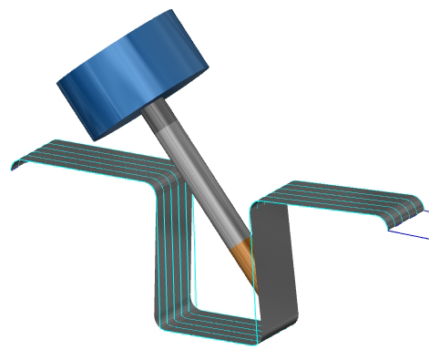

  • In this example the tool stays normal to the drive surface. The shape of the drive face forces the tool to gouge.

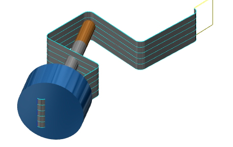

  • By using Use Lead/Lag Angle the tool tilts away from the collision.
Extra attention is required when using flat tools. When using an end mill, tilting forward or backward changes the contact point of the tool which can result in other collisions.
