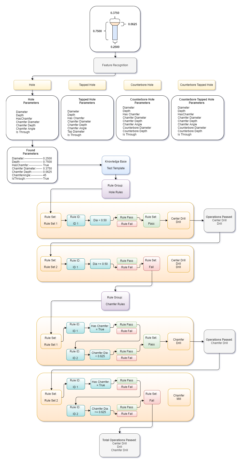

The Knowledge Base allows you to determine, in advance of a job, how to handle the 4 types of supported hole features BobCAM automatically recognizes:
  • Hole
  • Counterbore Hole
  • Tapped Hole
  • Counterbore Tapped Hole
The Knowledge Base contains templates comprised of various rules that you will define to determine which operations and parameters to apply to any geometry identified as one of these feature types. When a particular hole type is identified, the rules are then referenced in order to build the features and operations based on your specifications.

Since we have created the Diameter Rules first, one of its two rule sets will pass and add the operations from one of the rule sets to the Machining Strategy:
  • Rule Set 1:
    • Center Drill
    • Drill
  • Rule Set 2:
    • Center Drill
    • Drill
    • Drill
If a chamfer is detected, the one of the Chamfer Rules rules sets will pass and add its operation to the Machining Strategy:
  • Rule Set 1:
    • Chamfer Drill
  • Rule Set 2:
    • Chamfer Mill
