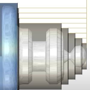

Depth of Cut - sets the spacing between toolpath passes.

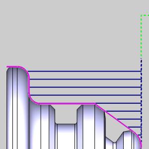

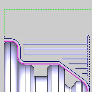

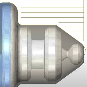

Rough Allowance -  Selecting this option will create a pass before the final pass to act as a semi-finish. The spacing of the semi-finish pass will be dictated by the values entered in the Z and X boxes.
No Allowance
Finish Allowance
Rough & Finish

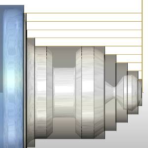

*Steps can also be eliminated with the Overlap options below.

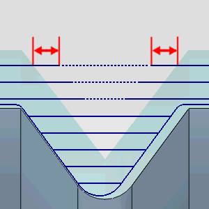

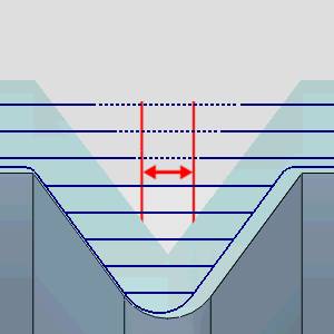

Overlap
The Overlap options allow you to create an additional move prior to the link to the next pass. This link will track back up the geometry in order to eliminate stair steps as seen in the images above. Overlap is controlled with either, To Previous Cut, No Overlap, or Custom Distance.
To Previous Cut - automatically tracks back up the geometry the distance of the selected depth of cut.
No Overlap - does not track back up the geometry at all.
Custom Distance - Allows you to enter a custom distance value. This value is a vertical distance. Entering the same value that has been entered for the depth of cut will track back to the last cut exactly.

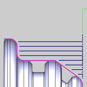

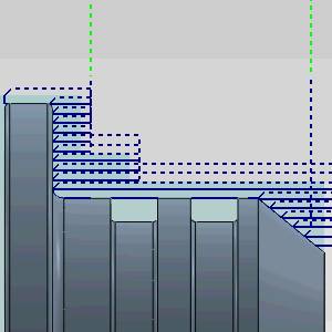

Bounds
Trim to Stock -  With this option selected, the toolpath that extends beyond the Operation Stock will be trimmed away.
