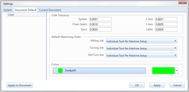

The Settings Dialog
The Settings Dialog is designed to put every setting in the same dialog. In the past, Settings Part was in one dialog, Settings Default was in another. This meant that you were doing a lot of jumping around in the software to get the settings the way you want them. Now this can all be done in the same dialog.
Document Default / Current Document
Another bonus of a single dialog is you only need to program your current and future part settings one time. We now offer a button that will apply the settings you have to the other tab. If you're in the Document Default tab, click Apply to Document to apply those same settings to the current document. If you're in the Current Document tab, click Apply to Default to apply those same settings to future documents. Just like that, everything is just how you like it.

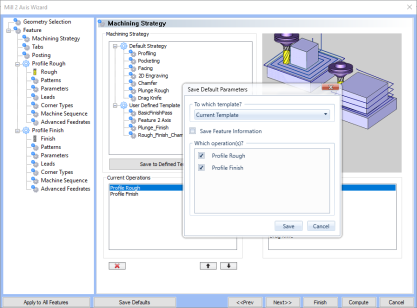

The Default Parameter Templates
The Default Parameter Templates are designed to let you change the initial values listed for the options in the CAM Wizards. When programming in BobCAM, you move through the wizards to edit the default values of the Features and Operations to create the program as you see fit. In the past, many customers have requested that those default values be changed to something that suits them better. However, the problem has always been, for every person that wants the value changed to one thing, there another person that wants it changed to something else. (And don't forget about the guy that likes it just the way it is!) Now, in BobCAM V8, we introduce the Default Parameter Templates. Simply move through the wizards and change any values you want to remain constant. Then use the Save Defaults option to save those values to a template. Once saved, any time that template is used the features and operations that have been saved to it will have those same values.

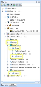

CAM Tree Flyouts
Here, at BobCAD-CAM, we are always trying to find ways to shave even more time off your part programming and make your software more user friendly. In this version, we're introducing CAM Tree Flyouts. These allow you to double check some, and even edit other values by simply hovering over certain items in your CAM Tree. Our CAM Wizards make programming incredibly easy, but having to find an item in the CAM Tree, edit that item, and then move to the proper page just to find that value can still seem a little frustrating. We don't want you to have to go through that, you've had a hard-enough day. With the CAM Tree Flyouts, hovering over an item will quickly give you access to information on the tools, stock, features, operations, and more! So now, even if you find yourself needing to update the speeds and feeds for the entire file, you'll be able to zip through and get it done with a smile.

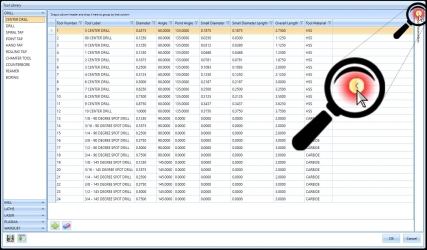

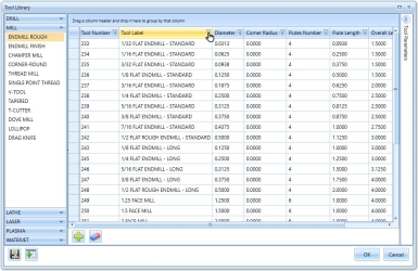

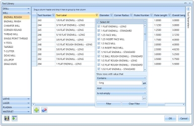

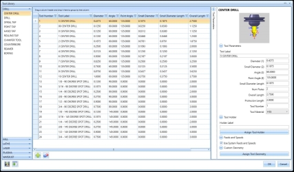

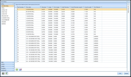

Redesigned Tool Library
In this release, the Tool Library has been updated to a more modern and intuitive interface. On top of that it now gives you the ability to add or modify tools without the need to open a new dialog, allows you to save additional copies of your library, and even has a powerful search/filter tool integrated into it.
The modern interface makes your tools and tool types easier to read, and the dialog itself can be resized:
With a single click, you can expand and collapse the tool parameters. This allows you to create and modify tools without the need to launch a separate dialog:
The new tool library also provides the means to group tools, and filter tools to make searching large libraries easier than ever before!
Drag and drop headers into the group area to group tools by column information:
The search filter can be a big help even in smaller libraries. With the filter open, you can easily Select All of the tools in the current group, and then set conditions to show only the tools you are interested in seeing.
These improvements make the tool library a much more powerful tool, while at the same time, making it easier than ever to use!

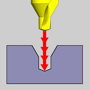

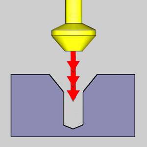

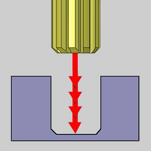

New Pecking Options
One of the most frequently requested features has been to include pecking options in more hole operations. In this release, BobCAM is giving you just that! While pecking has been an option in standard drill operations since the beginning, other operations have not had that functionality available. In this release you will find pecking options in the following operations:
  • Mill
    • Center Drill
    • Counterbore Drill
    • Chamfer Drill
    • Ream
  • Lathe
    • Lathe Center Drill
    • Lathe Chamfer
    • Lathe Ream
Center Drill Chamfer Drill Counterbore Drill Ream

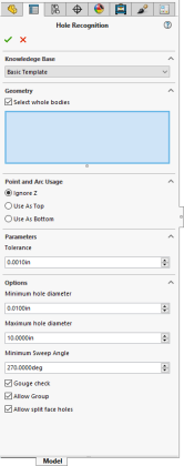

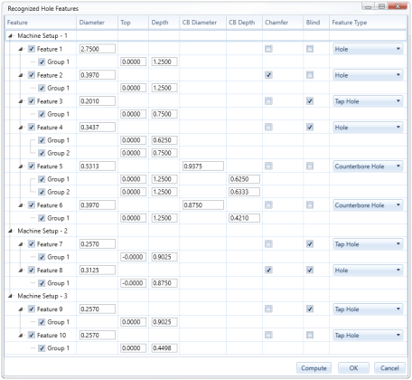

Hole Feature Recognition
We have taken Hole Feature Recognition to a whole new level in this release. Now, with a single click we recognize all four hole types, and their variations!
The machining features are automatically created based on a customizable set of rules in our new knowledge base, and all can be computed at once!
While BobCAM for SolidWorks has had hole recognition capabilities for some time, it was limited to creating a certain hole feature type and then finding the applicable holes when the model was chosen. In this release, feature recognition has been broken into several parts to give you the most control possible, while keeping things simple:
  • Step 1 – Launch Hole Recognition
  • Step 2 – Review found hole features
  • Step 3 – Done! All holes machined
Step 1 Step 2 Step 3

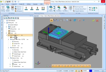

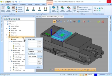

Work Offset Patterns
BobCAM now allows you to output copies of entire machine setups and allows you to specify different work offsets for each copy. While Toolpath Patterns have been offered in the past, and could be applied to Machine Setups, there was no way to output the same code with different work offsets. This could be a little frustrating when machining the same job on multiple locations on the table, because it meant you'd need to manually copy and paste the output, then adjust the work offset number of each copy by hand. Now, it's easy to create a Work Offset Pattern, set the work offset numbers to use, and set the machining order. You can also set a pattern type with distances to view the toolpath copies in the graphics area, and control whether the stock, fixtures, and workpiece are patterned in simulation. The Work Offset Pattern even gives you the ability to control in what order the code is output. Choose between By Tool Per Work Offset, By Tool, or By Work Offset.
Part Pattern Part Pattern
In the table below, you can see how these features are output using a single Work Offset Pattern copy.

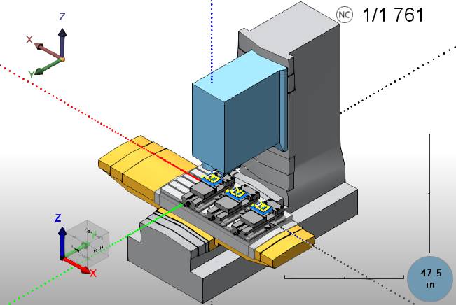

Simulation
Next Feed Move
In the Simulation, there are 3 new buttons added that give you the ability to jump over rapid moves to get right to the feed moves. Since feed moves are the only moves that should be removing material, there are times when you just want to focus on the next feed move. Now, the Run, Step Backward, and Step Forward buttons have a drop-down to allow you to change to Prev Feed Move, Feed Move Run, and Next Feed Move respectively. Each time one of the buttons are pressed, the simulation will jump, or fast simulate, to the first encountered feed move type get you past the rapids, and right to the feeds.
Move List Bookmarks
A new feature was added to Machine Simulator which allows you to add bookmarks to the move list with a simple double-click. Usually, when analyzing a simulation, there are portions of interest that the user returns to several times. Normally, this would be accomplished by remembering the operation number, and the block number, then moving to that operation, and going through the moves one by one. This can get difficult when you have a few different places you want to keep returning to. With bookmarks, you can double-click the move in the move list to add a bookmark to the progress bar:
Click the bookmark in the progress bar to bring the simulation to that precise move. It's never been easier:

Machine Coordinate System
A new coordinate system has been added to the Machine Simulator simulation area, called the Machine Coordinate System. This coordinate system is based on the machine definition, uses an internal detection algorithm for the main machine axis, and can be displayed on any corner of the simulation area. Some machines are created with coordinate systems that differ from the coordinate system shown in the simulation. This could be a little confusing when viewing the simulation, and in most cases, the best idea was to hide the Coordinate System to avoid confusion. In this release, the Machine Coordinate System has been added to the Graphics and Background page of the Machine Simulator Options dialog which allows you to view a coordinate system that is aligned with that of the machine.
