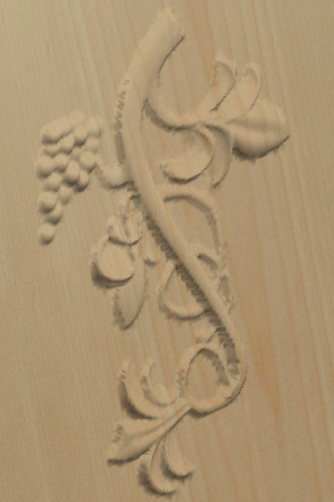

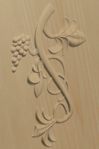

An important note about the appearance of the embossed model is the resolution parameter found in the Stock Parameters dialog box. The stock resolution is the DPI, or dots per inch, setting used for displaying the embossed model in the graphics area. The software automatically calculates the resolution based on the model size that you define. Lower values decrease calculation times and conserve system resources, but decrease the quality of the model appearance in the graphics area. Higher values provide a more accurate appearance, but may increase calculation times and require more system resources.
12*16 inch model | |
Low resolution (20) | High resolution (60) |
Tip: Lower the resolution to decrease regeneration times during creation. When the work is completed, or to check it along the way, increase the resolution and regenerate the model to get a more refined look.
