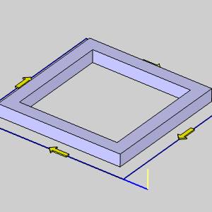

Lead-in
  • Vertical - generates a plunge feed move into the feature.
  • Parallel - generates a linear feed move into the feature parallel to the toolpath using the specified length.
    • Length - sets the length of the lead-in from the feature.
Lead-out
  • Same As Lead-in
Select this check box to use the Lead-in settings to automatically set the Lead-out settings.
Clear the check box to set the Lead-out independently from the Lead-in.
  • Vertical - generates a plunge feed move out of the feature.
  • Parallel - generates a linear feed move out of the feature parallel to the toolpath using the specified length.
    • Length - sets the length of the lead-out from the feature.
