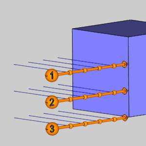

Single Step
When using the Side Roughing pattern, you are forcing several cuts to be made at a particular depth, each moving closer to the selected geometry. These cuts are basically an offset of the selected geometry, and can be accomplished with all cuts moving in a single direction, called Zig, or with each cut moving in reverse of the last, called Zig Zag.
Zig Zig Zag
Note: When using Zig Zag options, the final cut will always be moving in the same direction as the selected chain.
