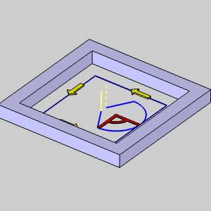

Lead-in
  • Vertical - generates a plunge feed move into the feature.
Warning: The Vertical Lead-in type is not actually a lead-in as it only creates a plunge move into the feature. Most machine controllers cannot apply compensation commands to a vertical plunge (Z-axis) move. (G41/G42 are not output when using the Vertical Lead-in.)
  • Parallel - generates a linear feed move into the feature parallel to the toolpath using the specified length.
    • Length - sets the length of the lead-in from the feature.
  • Right Angle - generates a linear feed at a right angle to the toolpath using the specified length.
  • Circular - creates a linear move followed by an arc sweep into the start of the feature. You have complete control over both the line move and the arc move using the following settings.

  • Blend - generates a linear move and then an arc move into the feature. This lead type can be used to lean-in and lead-out of the feature from the same point. The blend lead type creates a tangent path into the feature.
Line
  • Length - sets the length of the line segment.
Arc
  • Radius - sets the radius of the lead move into the start of the feature.
