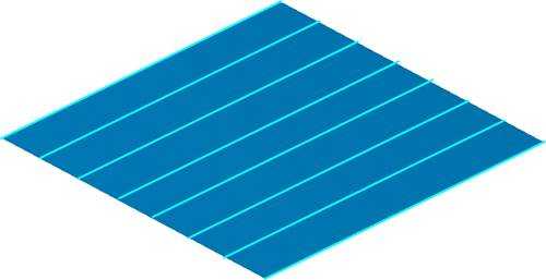

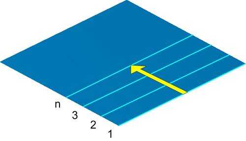

It is a little bit more complicated than swarf milling. Here you don't have a swarf face and you don't work with the side of the tool. You can't define if you are positioned right or left from the contour. Imagine that you are working on a flat face, machining simple parallel cuts. You just don't know where to align the tool because there are no side faces showing where there is material. Nevertheless, the function works as follows: In the flat face example, the paths are parallel to each other: - At first the only information about
any direction is the direction of the cut sequence. The machining
must start from one side.
- With this information you know where
there is remaining stock material. With this you also know in which
direction you have to move the tool to get climb or conventional milling.

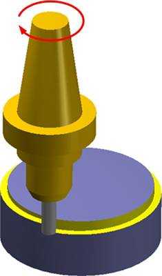

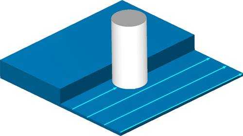

The following picture shows how a real machining would look. The side
of the material is defined depending on the cut sequence. Since the
spindle always rotates clockwise for a conventional milling as shown
in the picture, the tool has to move from the left to the right.

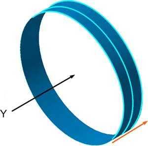

The direction is defined about the view direction onto the first cut. With the function you define two angles which span a plane (parallel cuts). The cuts are parallel to this plane. When you look perpendicular to that plane in the direction where the cuts proceed, you get the cutting direction defined. Both clockwise and counter-clockwise work well with Parallel cuts.
- In the following images, the black
arrows show the view direction. The view direction is defined
by the cut plane and the proceeding direction, which is the orange
arrow.
