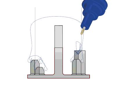

The tool Home Position for the feature is specified in the Retracts dialog box which is accessed from the Link tab. You must first select one of the following options to make the XYZ home position values available in the Retracts dialog box.
  • Start from Home Position
Select the check box to start the approach from the home position.
Clear the check box when not starting the approach from the home position.
  • Return to Home Position
Select the check box to return the tool to its home position after the operation.
Clear this check when not sending the tool to the home position after the operation.

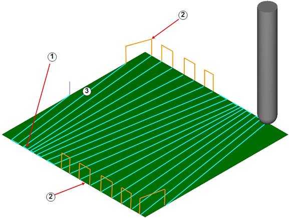

Small Gap Size - sets the threshold size for small gaps in one of two ways.
    • In % of Tool Diameter - is a percentage of the tool diameter.
    • As Value - determines the actual size of small gaps.
The following image shows small gaps (3) with Direct selected, and large gaps (4) with Retract to Feed Distance (2).

Small Move Size - sets the threshold size for small moves in one of two ways.
    • As Value - determines the actual size of small moves.
The following image shows small moves (1) with Direct selected, and large gaps (2) with Retract to Feed Distance.
