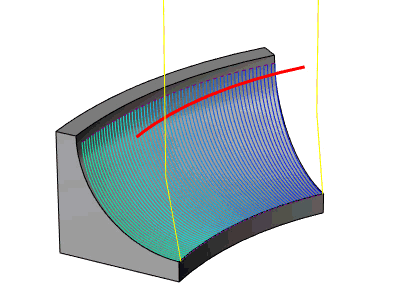

Tilted Through Curve
Tilted Through Curve - uses a geometry curve that is located above the drive surface. The tool axis orientation is aligned through the curve to the surface. The available parameters change slightly depending on which Curve Tilt Type is selected, so all of the parameters are explained together.
Tilt Curve - enables selection mode for you to select the tilt curve geometry. The tool orientation always points towards the tilt curve based on the selected Curve Tilt Type.
Tilt Angle - is an additional angle that is added to the tilting that is defined through the curve.
Curve Tilt Type - defines how the tilt curve is used when defining the tool axis tilting. Select from one of the following options.

Tilted from Curve Away - uses a curve that is located below the drive surface to define the tilting strategy. The tool axis orientation is aligned using the curve and the selected Curve Tilt Type.
Advanced - opens the Advanced Options dialog box with the following option.
Side Tilt Fanning Distance - smooths out sudden changes in tool orientation when cutting across multiple surfaces, or from one surface to another. This distance defines how far from the intersection of the surfaces the tool begins to change orientation.
When using Tilted Through Curve with Angle from Spindle Main Direction and a Tilt Angle greater than zero, the following options become available (in addition to the Side Tilt Fanning Distance).
Curve Tilt Fanning Distance - smooths changes in tool orientation when cutting across the selected tilt curve. This distance defines how far from the curve the tool begins to change orientation.
Snap to Curve - causes the tool to snap to the tilt curve when crossing it. This can be used to create a smoother tool orientation changes when the tool crosses the tilt curve.
View Curve Snapping and Fanning
Off Example
