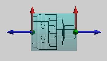

  1. Next we define the machining origin for Machine Setup 1. You can see that the software automatically created bounding entities in the graphics area to assist with the origin selection.
Under Origin, the Pick Origin box is already selected so we can select the origin from geometry in the graphics area.
  1. Click to select the point at the front of the stock.
The origin updates to the selected point.
Modify the Direction of the Machining Origin Axes
Next we modify the direction of the machining origin axes to align it to the machine zero (coordinate system). We need the Z-axis to be at the center line or rotation axis of the part to match the Z-axis of the machine.
  1. Under Origin, click in the X Axis box, and click to select the vertical edge of the model as shown next.
The X-axis direction of the machining origin updates (shown by the red arrow) based on our geometry selection.
  1. Click in the Z Axis box, and click to select the line on the side of the part.
The Z-axis direction of the machining origin is now parallel to the selected line, but is currently backwards, so next we use the reverse direction button.
  1. Next to Z Axis, click the (reverse) button.
Note: For Mill Turn jobs, you have the freedom to create and orient the part any way that you like, thus you must orient the machining origin as needed to accommodate your part orientation. An important note here is that the software analyzes the part model in the XZ plane when creating turning features. (The XZ plane is the default, which can be modified during geometry selection.) Also, if you want to use sketches for lathe profiles, create them in the XZ plane of the machining origin to reduce the need to change parameters during geometry selection. (An example is shown next. The red arrow of the gnomon indicates the positive X-axis direction and the blue arrow indicates the positive Z-axis direction.)
All axes now point in the proper direction for a Mill Turn job, but we want our machining origin to be zeroed at the face of the part and not the stock. Next we adjust the origin location.

  1. The Pick Origin box is already selected, so click the point at the center of the model to set the origin location.
The machining origin moves to the selected point.
Again, we must align the machining origin to use the appropriate direction for each axis.
  1. Under Origin, click in the X Axis box, and click the point on top of the model. Be sure to select the point and not the line.
Notice we can select a point (or a vertex) to set the direction of any axis.
  1. Click in the Z Axis box, and click to select the line on the side of model.
The Z-axis now aligns to the selected entity direction, and our machining origin if properly defined. You should have the same axes directions as shown in the previous image.
Note: We are creating the same alignment for the front and back machine setups (the X-axis and Z-axis) as shown next. When creating turning features, the part profile is analyzed starting from the XZ plane.
Again, if using sketch geometry for our profiles, they are aligned to the XZ plane.
We want this machining origin to be zeroed at the face of the part, so next we adjust the origin location as we did for the first machine setup.
