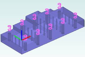

Part 1) Ignore Z
The Ignore Z option allows you to select geometry that is above or below the actual hole location and have the software ignore the Z-axis value of the geometry. This way you can set the top of feature and feature depth for each hole group yourself.
The following image shows an example drilling part and arc geometry that is selected from above the actual hole locations. The Ignore Z option is selected for this scenario.
When using this option:
  • The Top of Feature defaults to 0.000
  • The Feature Depth defaults to 0.500
  • The Diameter is automatically set from the selected arcs
    • (If points are selected, the Diameter defaults to 1.000)
When we navigate to the Feature page of the wizard, we see that a single hole group is created because all of the holes share the same Diameter, Top of Feature, and Feature Depth. Note that one feature is created for each diameter.
After selecting the group in the Hole Groups list, the preview displays showing these settings as described.
The next step is to break the hole group and regroup the holes. For information on breaking and regrouping the holes, view the Break and Regroup Holes Example. After breaking and regrouping the holes for each level of the model, the Top of Feature and Feature Depth can be set for all hole groups.

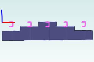

Part 2) Use as Top
The Use as Top option allows you to select geometry that is at the top of the hole and have the software calculate the toolpath using the Z-axis location of the geometry.
The following image shows an example drilling part and arc geometry that is selected at the top of each hole. (Note that this could be arcs or the surface edges themselves.) The Use as Top option is selected for this scenario.
  • The Top of Feature is automatically set using the Z-axis location of each arc (or surface edge)
When we navigate to the Feature page of the wizard, we see that three hole groups are created: one for each Top of Feature. (Note that two features are created, one for each diameter.)
The next step is to set the Feature Depth for each hole group. For the example part shown, two of the groups are broken to separate the groups that contains holes on opposite sides of the part. To learn more, view the Break and Regroup Holes Example.
