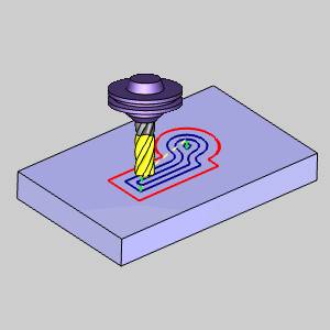

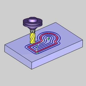

Boundary Options
Boundaries are used to contain the toolpath of the operation to stay within the specified area. The Boundary Options determine where the tool cuts when it reaches the boundary in one of three ways.
Center of Tool - forces the center of the tool to cut directly on the specified boundary.
Tool Inside - forces the entire tool to stay inside of the boundary. (This offsets the toolpath to the inside of the boundary by the tool radius.)
- Offset - is used to add an additional offset to the location of the tool at the boundary when using Tool Inside or Tool Outside. When using Tool Inside, the tool stays inside of the boundary by the specified distance. When using Tool Outside, the tool goes outside of the boundary by the specified distance. Note that positive or negative values are supported.

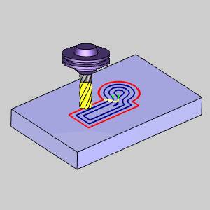

Tool Outside - forces the entire tool to go outside of the boundary. (This offsets the toolpath to the outside of the boundary by the tool radius.)

- Select the check box to create fillets in the sharp corners of the toolpath. The fillet is not applied to the outer contour as it is with Smooth Final Contour. When selected, the Smooth Distance/Stepover % parameter becomes available as well as the Smooth Final Contour option.
- Clear the check box to turn off Smooth Corners.
- Smooth Distance/Stepover % - With the Smooth Corners check box selected, the Smooth Distance/Setpover % sets the
radius of the fillet as a percentage of the stepover distance.
- Smooth Links
- Select the check box to smooth the links within a group. The last segments of the previous contour and the first segments of the next contour are trimmed. The connecting link connects diagonally. In the case of an S-Link the connection is an S-type link.
- Clear the check box to turn off Smooth Links.

- Smooth Final Contour
- With the check box cleared, the Smooth Final Contour option is not used.
- Select the check box to create fillets in the sharp corners of outer contours. The Smooth Distance/Stepover % parameter becomes available.
% - sets the radius of the

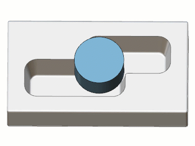

- Remove Corner Pegs
- Clear the check box to turn off Remove Corner Pegs.
- Select the check box to add extra tool movement in corners, removing the rest material; for use when a stepover greater than 50 percent results in small pegs of material remaining in the corners. With this check box selected, you will be able choose between the following three options.
- Line-Arc-Line - removes the corner pegs with an arc between two lines as seen in the animation below.
- Arc - removes the corner pegs with a single looping arc motion as seen in the animation below.
- Line - removes the corner pegs by moving away from, and back to the toolpath with a straight line as seen in the image below.

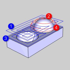

Processing
Sorting
By Area - machines an entire area of the part before moving on to the next.
By Level - machines all areas of the part to the current pass depth before beginning the next pass.
Intermediate Steps
- After
Last Depth Step - cuts all intermediate slices for the entire
model after the final depth step of the operation.
- After Each Depth Step - cuts the
intermediate slices for each depth step immediately after finishing
each depth.
