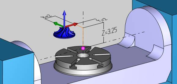

    • The X, Y, and Z boxes are used to define the distance from the machine zero (the top and center of the table, not the tool home) to the selected Machine Setup coordinate system or origin. This is required for proper machine simulation. An example of this is shown in the next image.
