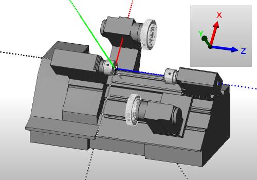

Machine Definition and the Virtual Machine Zero/Coordinate System
When creating or programming a mill turn machine, you must think about the machine zero and the direction of each axis in this coordinate system. The virtual machine zero is our primary reference in the software and all BC machines use the same location, the front face of the main spindle. For example, when setting the machining origin (work offset) in the software, it is in reference to the virtual machine zero. When setting up the machining origin (work offset) on the physical machine, the machine controller handles the machine zero location that is most likely not the same as the virtual machine zero.
All geometry files are aligned to the virtual machine zero for the machine definition, and this is also our reference for creating tool adapters and when mounting adapters and tools to the machine devices in the tool crib.
Tip: The arrows of the coordinate system gnomon indicate the position direction of each axis. Notice that the Z-axis is the center line of rotation for the lathe spindles. This reference is also helpful when mounting tools in the tool crib.
