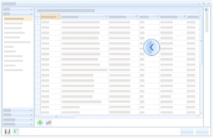

Tool Parameter Grid Splitter
Upon opening the Tool Library, the Tool Parameter Dialog will be collapsed. To expand the Tool Parameter Dialog, click the
chevron icon. With the Tool Parameter Dialog expanded, click the
chevron icon to collapse it. The Tool Parameter Grid Splitter can also be used to resize the Tool Parameter Dialog. Hover over the left side of the Tool Parameter Grid Splitter until the mouse icon displays as the double headed arrow. You can then hold left-click and drag the dialog to the desired size.

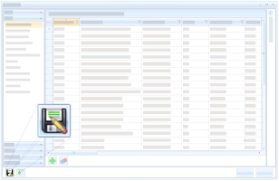

Saving the Library
Libraries can be saved in order to share the library between work stations, or can be saved to move your library from an older version of BobCAM to a newer version.
To save your tool library:
- Click the
Save As button on the bottom left.
The Save As dialog appears. - Choose a name and a location for the file.
- Click Save.
The file is saved.
