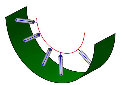

  • This Closest Point example shows a curved surface with a tilt curve placed above. It has the same shape as the surface but a smaller radius. Now take any point on the surface and connect it with the curve by using the shortest distance. The result is that the tool axis is always normal between the curve and the surface.

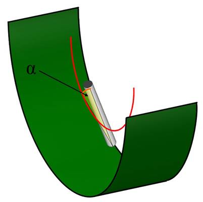

  • Closest Point with Fixed Tilt Angle set to 10 degrees.

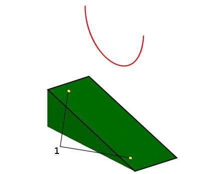

  • A surface with a tilt curve above and two random toolpath points (1).

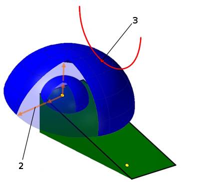

  • Now a sphere is expanded (2) from the point until it reaches the tilt curve. This sets the closest point on the tilt curve (3).

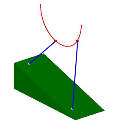

  • Finally, a line is created between this point on the curve and the toolpath point. This line is the tool axis orientation.
