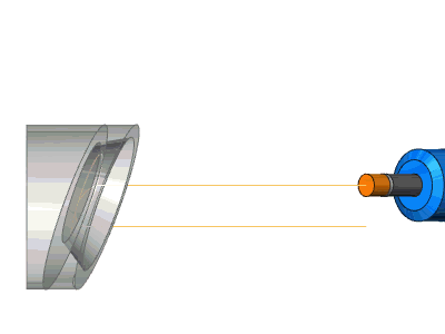

This parameter sets the output to 4- or 5-axis. The output for 5-axis uses complete freedom of the tilt range. For 4-axis this freedom is limited by 1 degree. So for 4-axis output a portion of the 5th axis is projected back onto the selected 4th axis. Interesting here is the influence on the behavior of the tool contact point.

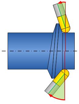

The following descriptions are related to the examples in the next images. The tool is performing a flank milling around that cylinder, along the wall. The tilt angle on the wall changes as it goes around the cylinder. The toolpath pattern is Parallel to Surface. The drive surface is the wall, the guiding surface the floor (cylinder).

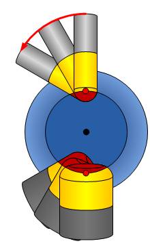

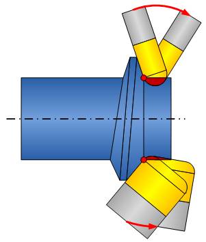

5-Axis Output Format
Tilting - for the 5-axis output no axis limitation is set on the tool tilting. That means that the tool can tilt sideways (left image) and lead tilt (right image) as it goes around the wall.
Contact Point
On the Drive Surface - is always fixed. It always is positioned close to the drive surfaces edge.
On the Tool - for ball-mill tools as well as bull-mill tools it is always on the radius of the tip. For flat-end tools it is on the edge.
For the side-tilt direction (left image) and the lead-tilt direction (right image) the tool always rotates around the surface contact point (red dots). You can see that in this example the ball-mill tool gouges because of the tight surface contact point between the wall and the cylinder floor surface. This won't be compensated automatically so gouge checking is necessary.

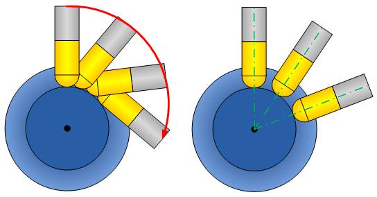

4-Axis Output Format

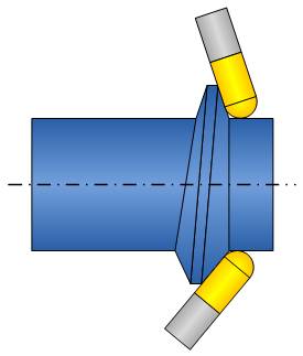

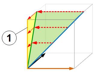

Tilting - the images show the progression: 5-axis, projection of 5th axis, and 4-axis.
When using only 4-axes then the 5th component of tool-axis vector (2) is projected onto the plane (3) of the of the 4th-axis (1).
While for 5-axis output the side tilt constantly changes, in 4-axis the side tilt angle is fixed. Flank milling is not possible anymore for this part.
While the side tilt is fixed, the tool is still able to tilt in the 4th-axis lead and lag direction.

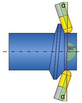

Lock the Fifth Axis At - sometimes, the 4-axis machines have a fixed-tilt head mounted, like a 45-degree head. In this case the spindle direction is, for example, tilted 45 degrees to the rotary-axis vector. Then the locked axis value must be set to 45 degrees. The 45 degree angle means that the vector, from the tool tip towards the spindle direction, and the rotary axis vector [for example, X-axis vector which is (1,0,0)] both have a 45 degree angle to each other. Another usage of this parameter is in combination with a 5-axis machine. In order to reduce rotary-axis motion it might be desired to use a 5-axis machine, but still set the toolpath output to 4-axis with a fixed 5th axis angle. This means that one of the rotary-axes is fixed for the entire toolpath.
Point Tool to Rotary Axis - here the tool is forced to tilt through the rotary axis (right image) and can no longer tilt in lead/lag direction.
