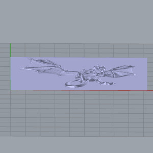

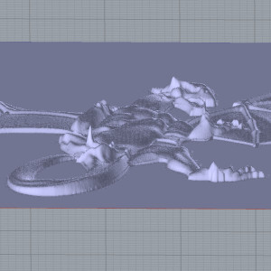

  7. Right-click Emboss Model, and click Regenerate.

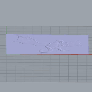

The result is shown next.
In the previous image, the maximum height in Z is less than 2.540.
The default value of 2.540 is small for this example.
The next step is to modify the Z Depth.
Part 3) Edit the Feature and Regenerate the Model
  1. In the BobART tree, right-click My Image Emboss 1, and click Edit.
  2. In the Model Size group, set the Z Depth to 25.
  3. To accept the change, click OK.
    Notice the feature in the BobART tree. The Emboss Model icon and the My Image Emboss 1 icon are displayed with a red x. This shows that changes have been made that have not been added to the model. The model needs to be regenerated.

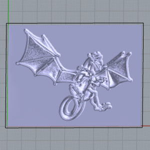

  4. To add the changes to the model, right-click Emboss Model, and click Regenerate.
Note: Every time that you modify the parameters or the geometry/image of an emboss feature, the results are not added to the model until you Regenerate to calculate the changes.
The maximum Z Depth of the feature is now 25.
Notice that the emboss is much more prominent than in the previous result.

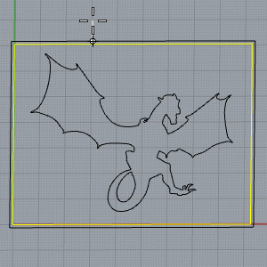

In the next part of this tutorial, you learn how to Vectorize an image that is used to create the profile of the dragon. The geometry is then used to contain a Smoothing feature. This geometry is also used to create an emboss feature that contains all of the areas around the dragon. After creating the second feature, the dragon can then be saved as a component that only contains the dragon, not the entire emboss from image feature.

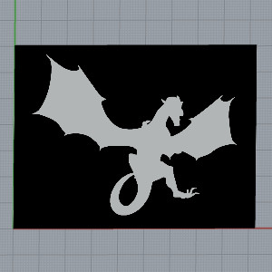

Example 2: Vectorize - 2 Color (Black and White) Strategy
Part 1) Vectorize an Image - 2 Color (Black and White) Strategy
For this part of the tutorial, a black and white image of the dragon is loaded into the system and vectorized to create geometry that is used later.
  1. To hide the current embossed model, right-click Emboss Model, and click Blank/Unblank.
  2. In the BobART tree, right-click Images, and click Load Image.
  1. In the Open dialog box, locate and select Dragon Black and White.png, and click Open.
Tip: When locating an image file, it can be helpful to show all file types in the Open dialog box. This allows you to see all image files that are contained in each folder. To show all files: at the bottom of the Open dialog box, click the Files of Type arrow, and at the bottom of the list, select All Files.
The image is loaded into the graphics area with the image origin (the lower-left corner) placed at the WCS or world coordinate system origin. Note that an Image feature is added to the BobART tree under Images. (If you want to change the default location, right-click Image-image name, and click Change Origin.)

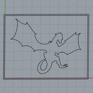

  1. Under Images, right-click Image-Dragon Black and White, and click Vectorize.
    The Raster to Vector dialog box is displayed.
  2. In the Vectorize Strategy group, select 2-Level (Black/White) Strategy.
    The Threshold Value is set to 2. (For this example, no changes are made to the default settings.)
  3. To vectorize the image using the defined parameters, click OK.
  4. To hide the image and view the geometry, right-click Image-Dragon Black and White, and click Blank/Unblank.
This concludes the vectorization example. The geometry that you created is used in the next three parts.

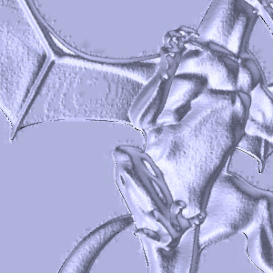

When you zoom-in to view the model up close, you can see that the result of embossing the height-map image has left a texture/grainy appearance on the model. This appearance may or may not be desired. For this example, we use smoothing to remove this from the model surface. The areas of the model that we want to improve are shown next.
  1. Right-click Emboss Model, and click Smoothing.
  2. In the Boundary Based Smoothing dialog box, leave the default settings, and click OK.
  3. In the BobART tree, under Smoothing 2, right-click Geometry, and click Re/Select.
Zoom in, if needed, and select the each of the three chains of the image.
To confirm the selection, click OK.
Note: When using a Smoothing feature, by default, the smoothing is applied to the entire model. (You do not have to select geometry.) When you select geometry to contain the smoothing feature, it is only applied within the selected boundaries.
To show the embossed model again, right-click Emboss Model, and click Blank/Unblank.

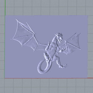

  1. To update the model, right-click Emboss Model, and click Regenerate.
    You can see that the surface of the model has been improved, but it can still be improved further.
  2. In the BobART tree, right-click Smoothing, and click Edit.
    In the Smoothing Parameters group, change the Smoothing Window Size to 2.50.
    This increases the amount of smoothing applied.
  3. Click OK and Regenerate the model, as done previously.
The surface of the model has been greatly improved and the smoothing is now complete. This concludes the Smoothing portion of this tutorial.

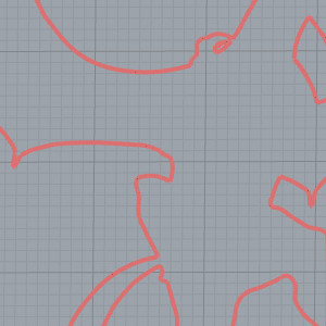

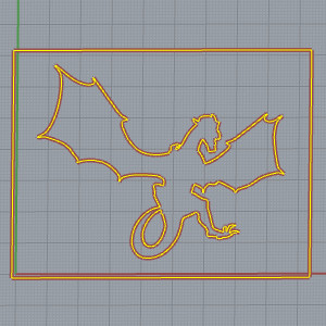

Part 2) Create an Offset
In the next part of this tutorial, you create an Emboss Regular feature. The geometry that was created from the boundary of the image is the same size as the model/feature. Because they are the exact same size, you offset the geometry to assure that no artifacts are created at the edge of the model.

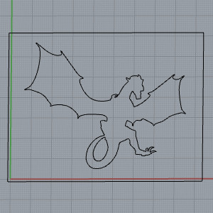

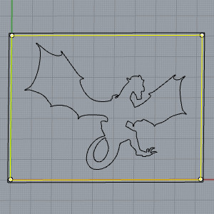

  1. In the Command Line, type Convert and press Enter to use the Convert function, then select the rectangle and right-click twice to complete the function.
    The geometry is now able to be offset.

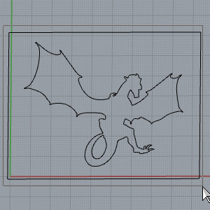

  2. In the Command Line, type Offset and press Enter.
  3. Set the distance to 6, then select the rectangle and choose an offset to the outside by clicking outside of the rectangle.

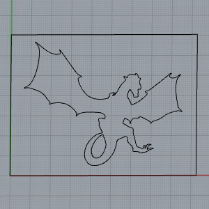

  4. Select the inner rectangle and click Delete.
Now the boundary that is used to create the Emboss Regular feature is larger than the model.
This assures that the Emboss Regular feature covers all unwanted areas of the model.

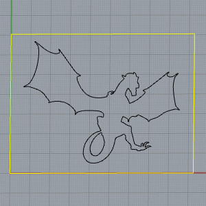

  3. Under Regular Emboss 3 - Add, right-click Geometry, and click Re/Select.
  4. Select the geometry for the emboss.
  5. To confirm the selection, click OK.
