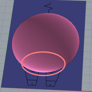

Part 2) Regular Emboss 1 - Body
Insert the Feature and Define Stock
  1. In the BobART Manager tab, right-click Emboss Model, and click Emboss Regular.
    The Stock Parameters dialog box opens.
  2. In the Model Size group, set the X value to 229.000, and set the Y value to 305.000.
The Emboss dialog box opens.
Edit the Feature Parameters
  1. Click Color, select pink, and click OK.
  2. Click the Cross Section arrow, and click Convex Ellipse.
    In the Major Axis box, type 102.000.
    In the Minor Axis box, type 13.000.
  3. Click the Application Type arrow, and click Add.
The Add application type adds the emboss to the stock surface.
Click OK.

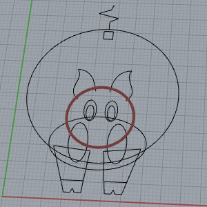

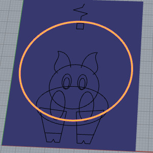

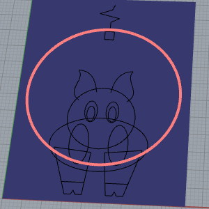

Select Feature Geometry
  1. Under Regular Emboss 1 - Add, right-click Geometry, and click Re/Select.
  2. In the graphics area, select the geometry that represents the body of the pig as shown next.
To confirm the selection, click OK.

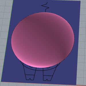

Generate the Emboss
  1. Right-click Emboss Model, and click Regenerate.
The body is now embossed and appears as shown next.

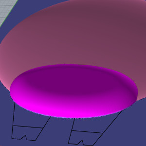

Part 3) Regular Emboss 2 - Nose
Insert and Edit the Feature
  1. Right-click Emboss Model, and click Emboss Regular.
  2. Click Color, select pink, and click OK.
  3. Under Emboss, click the Cross Section arrow, and click Convex Ellipse.
    In the Major Axis box, type 19.000.
  4. Under Application Type, click the arrow, and click Merge High.
Click OK.
Note: Most, but not all of the nose geometry overlaps the body geometry. Merge High is used to create the nose with one consistent height. If the Add application type is used, then the area of the nose that does not overlap the body geometry would not be the same height as the rest of the nose (this is shown at the end of Part 3). Merge High leaves only the highest area of intersection between two embossed features.

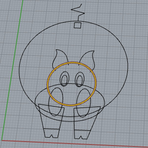

  1. To hide the embossed model, right-click Emboss Model, and click Blank/Unblank.
  2. Under Regular Emboss 2 - Merge High, right-click Geometry, and click Re/Select.
  3. In the graphics area, select the geometry that represents the nose of the pig as shown next.
Tip: To hide or show the stock, right-click Emboss Model and click Blank/Unblank. This is helpful when you have already created an Emboss feature but need to select geometry that is hidden within (or behind) the stock model.

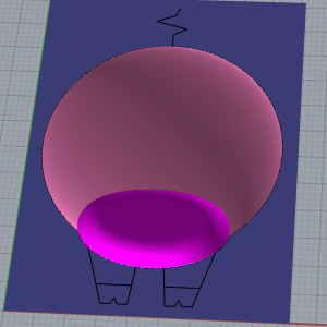

Generate the Emboss
  1. To show the embossed model, right-click Emboss Model, and click Blank/Unblank.
    (You can also click in the graphics area and press E.)
  2. Right-click Emboss Model, and click Regenerate.
The nose is now embossed and appears as shown next.
For comparison, an image of the same feature is shown using the Add application type as mentioned previously.

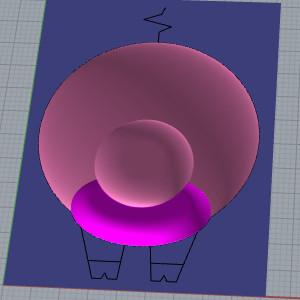

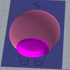

    Notice that the face emboss does not show. This is because the height of the body is greater than the height of the face, and the Merge High application type is used.
  3. To edit the feature, right-click Regular Emboss 3 - Merge High, and click Edit.
    In the Base Height box, type 13.000.
    This adds a 13.000 mm foundation to the base of the emboss feature which can now extend up through the body.
    Click OK.
  4. Right-click Emboss Model, and click Regenerate. The result should look as follows.

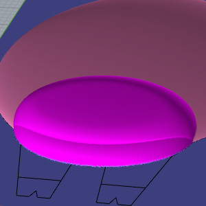

  5. Notice that the face now covers the nose. This is not the desired result. To resolve this issue you add a base height to the nose emboss operation.
  6. Right-click Regular Emboss 2 - Merge High (nose), and click Edit.
    In the Base Height box, type 10.000. This adds a 13.000 mm foundation to the nose feature.
    Click OK.
  7. Right-click Emboss Model, and click Regenerate. The model should appear as follows.

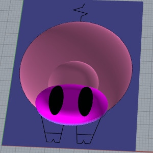

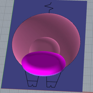

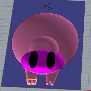

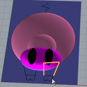

Part 5) Regular Emboss 4 - Nostrils
  2. Click Color, select black, and click OK.
  3. Under Cross Section, select Convex ARC.
Confirm the Radius is set to 6.000.
In the Start Angle box, type 60.00.
Confirm the End Angle is set to 90.00.
Tip: Notice that the Start Angle is changed to 60 degrees, instead of 0 degrees. The embossed model now starts 60 degrees into the defined Cross Section. The result is that the edge of the model has a more gradual slope in relation to the stock. The following image shows two identical Regular Emboss features with the first starting at 0 degrees, and the second starting at 60 degrees.
It is important to explore the various settings of the Emboss features. Changing one setting can create a substantial difference in the result. By experimenting with the different settings, you can find multiple ways to accomplish the same task, with variations in the result. Knowing these variations helps you greatly when creating embossed models.
  1. Click the Application Type arrow, and click Subtract.
The Subtract application type removes material. This makes the nostrils recessed into the nose.
Click OK.
  2. Under Regular Emboss 4 - Subtract, right-click Geometry, and click Re/Select.
  3. In the graphics area, select the geometry that represents the nostrils of the pig as shown next.
Generate the Emboss
  2. Right-click Emboss Model, and click Regenerate. The result is shown next.

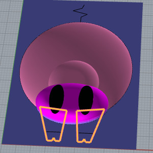

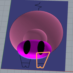

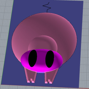

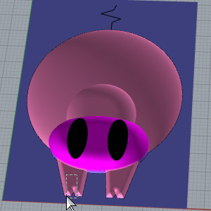

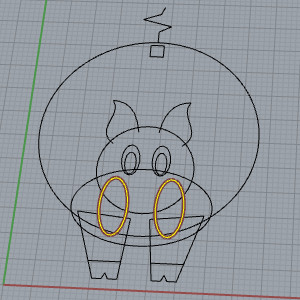

Part 6) Regular Emboss 5 - Legs
    Confirm the Start Angle is set to 0.00.
  4. Click the Application Type arrow, and click Merge High.
Click OK.
  1. Under Regular Emboss 5 - Merge High, right-click Geometry, and click Re/Select.
  2. In the graphics area, select the geometry that represents the legs of the pig as shown next.
Repeat this process for the other leg.
Generate the Emboss

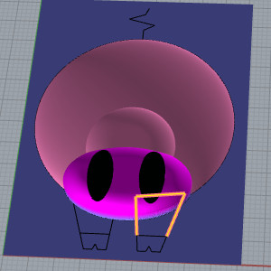

  1. Right-click Emboss Model, and click Regenerate. The result is shown next.

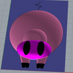

Part 7) Regular Emboss 6 - Feet
    In the Radius box, type to 3.000.
  4. Click the Application Type arrow, and click Add.
Click OK.
  1. Under Regular Emboss 6 - Add, right-click Geometry, and click Re/Select.
  2. In the graphics area, select the geometry that represents the feet of the pig as shown next.
Then repeat this process for the other foot.

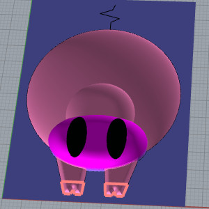

Generate the Emboss
  1. Right-click Emboss Model, and click Regenerate. The result should look like next image.

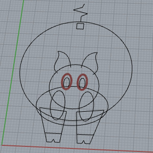

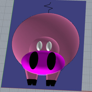

Part 8) Regular Emboss 7 - Eyes
  2. Click Color, select white, and click OK.
    In the Radius box, type 3.000.
  5. In the Base Height box, type 19.0005.
Click OK.

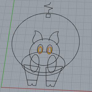

  1. Hide the embossed model.
  2. Under Regular Emboss 7 - Merge High, right-click Geometry, and click Re/Select.
  3. In the graphics area, select the geometry that represents the eyes of the pig as shown next.
Generate the Emboss
  1. Show the embossed model.

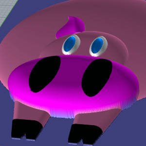

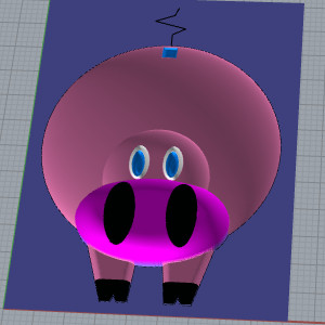

Part 9) Regular Emboss 8 - Pupils
  2. Click Color, select blue, and click OK.
  4. Click the Application Type arrow, and click Subtract.
Click OK.
  2. Under Regular Emboss 8 - Subtract, right-click Geometry, and click Re/Select.
  3. In the graphics area, select the geometry that represents the pupils of the pig as shown next.
Generate the Emboss
  2. Right-click Emboss Model, and click Regenerate. The result should look as follows.

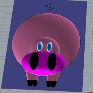

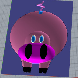

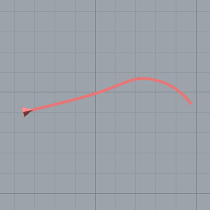

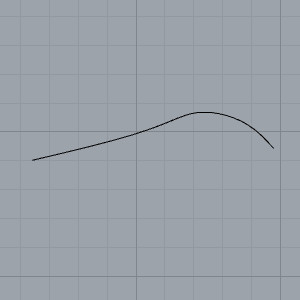

Part 11) Swept Emboss 10 - Tail
  1. Right-click Emboss Model, and click Emboss Swept.

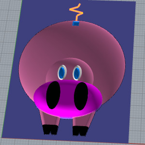

Click OK.

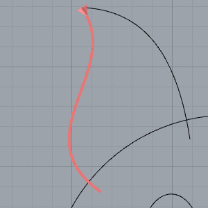

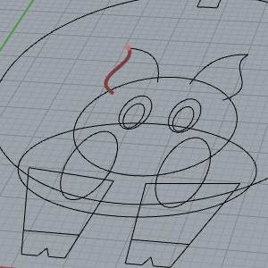

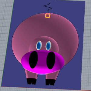

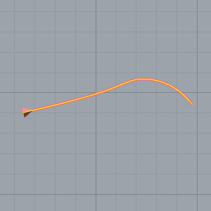

Select the Geometry
  1. Under Regular Emboss 10 - Merge High, right-click Geometry, and click Re/Select.
  2. In the graphics area, select the geometry that represents the tail of the pig as shown next.
To confirm the selection, right-click anywhere in the graphics area.
Tip: Notice that the tail geometry is not a closed entity. This is why the Emboss Swept feature is used. The Emboss Swept feature allows the use of open or closed feature geometry, and it creates an emboss using the geometry as the center line for the feature.
At this point, the feature tree is becoming rather large. You may want to collapse a few of the features to save space in the BobART Tree. To collapse the features, click the icon next to each feature name.

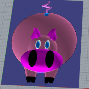

Generate the Emboss

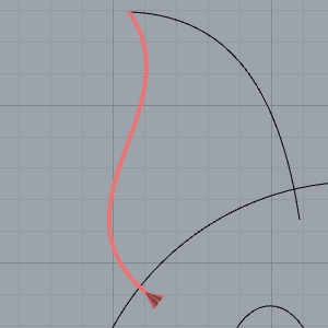

Part 12) Emboss 2-Rail Sweep 11 - Right Ear
  1. Right-click Emboss Model, and click Emboss 2 Rail Sweep.

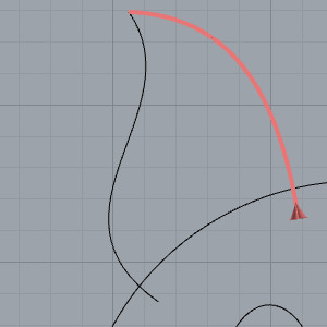

  1. Under 2 Rail Sweep 11 - Merge High, right-click Rail 1-Geometry, and click Re/Select.
  2. In the graphics area, select the geometry that represents the outer edge of the pig's right ear as follows.
The chain direction should point up away from the pig's face as shown in the preceding image on the right.
Tip: To reverse the chain direction, right-click the Rail Geometry (or Cross-Section Geometry) item, and click Reverse Direction.
  1. Under 2 Rail Sweep 11 - Merge High, right-click Rail 2-Geometry, and click Re/Select.
    In the graphics area, select the geometry that represents the inner edge of the pig's right ear as shown in the next image.
    The chain direction should point up away from the pig's face as shown in the previous image on the right.
  2. Right-click Cross-Section Geometry-1, and click Re/Select.
  3. In the graphics area, to the left of the stock, select the geometry, and right-click anywhere in the graphics area.
The chain direction must match the image shown.
Generate the Emboss
  1. Right-click Emboss Model, and click Regenerate. The model should appear as follows.

  1. Right-click Emboss Model, and click Regenerate. The model should appear as shown next.
    Tip: The direction of the cross section geometry determines the result of the emboss. If the result is not one you expected, reverse the direction of the corss section and regenerate. Notice in the following images how reversing the cross section can influence the resulting shape of the left ear:
  2. Now right-click Emboss Model, click Create/Modify Stock.
  3. In the Resolution box type 13, and click OK to close the dialog box.
  4. Right-click Emboss Model, and click Regenerate to create the embossed model at the higher resolution. The result is shown next.
You can improve the appearance of the embossed model by modifying the stock resolution.
This concludes the tutorial.
