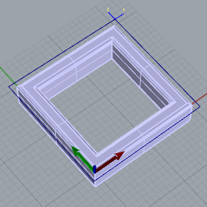

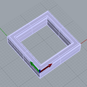

The following image shows the part used in this example with the machining origin set to the top of the part.

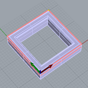

Part 2) Select the Feature Geometry
  1. Under Geometry Selection, click Select Geometry.
    The FeatureGeometry Picking dialog appears with the focus on the Selected Geometry list to allow you to select geometry for the feature.

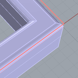

  2. You can select wireframe or surface edges for the operation.
For this example, point to the outer surface edge at the bottom of the fillet.
The feature preview appears. Note that you could also select the bottom surface edge of the part for this example, as long as you select the outer profile of the part.
The Z-level of the selected geometry is not extremely important for this example because the depth of the feature is set using the Top of Feature and the Total Depth.

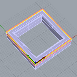

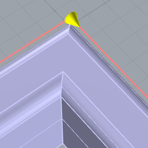

Setting the Chain Start Point and Direction
  1. In the Profile Chains list, select Chain-1.
    The Chain highlights in the graphics area and the start point and the direction of the chain are shown as an arrow.
  2. Next to the Profile Chains list, click (Reverse Direction) to reverse the direction of the chain.
    With the default setting of Left for the System Compensation, the clockwise motion on the outside of our part will create a Climb cut.

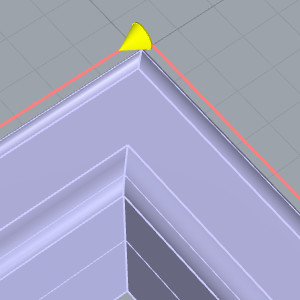

Defining the Total Depth of the Feature

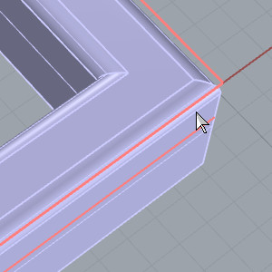

Next we use the Pick Bottom list to update the Total Depth value for the feature.
  1. Under the Feature Parameters, in the Total Depth group, click in the Pick Bottom list to give it focus.
  2. Click on the bottom edge of the fillet on the model to set that as the total depth of the feature.
    The Total Depth updates along with the preview.

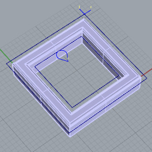

Part 4) Create the Second Feature
For this example part, there is also an internal feature that needs cut. Because we want to use a different lead type on the inside, a second feature is created. Note that this feature could also contain a Pocket operation and/or Profile operation in addition to the Corner Rounding operation. For this example, we only create the Corner Rounding operation.
  1. In the CAM Tree, right-click the Feature 2 Axis and select Copy.
  2. In the CAM Tree, right-click the Feature 2 Axis and select Paste.
    A dialog appears asking Do you wish to load the Top of Feature and Depth values?
  3. This dialog gives us the opportunity to copy the feature while leaving the Top of Feature and Total Depth values at their usual default values. In this case we want to use the same Top of Feature and Total Depth values.
    Click Yes.

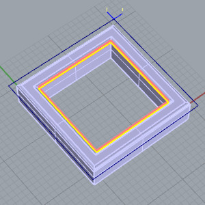

  1. In the new Feature 2 Axis, right-click on Geometry and click Re/Select.
  2. Select each of the lower edges of the inner fillet.
    The feature preview appears. Notice the Total Depth already has the proper value.
    Since the System Compensation in our feature is already set to Left, our chain direction is also correct.
