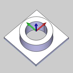

The part geometry for this example is shown next. Stock has been created using the Solid Model option, and the machining origin is placed at the top and center of the stock. Because we are making a 2-inch ID thread, the hole diameter of the part is 1.8125 inches.

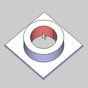

  2. In the Geometry Selection page, click Select Geometry.
    The Mill Thread Wizard disappears and the Hole Geometry Picking dialog launches.
  3. Click the inner cylindrical surface of the part model.
To confirm the selection, click .
  1. Click Next>> to start defining the Feature parameters.

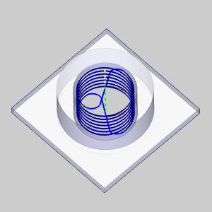

  7. Click Next>>, and in the Lead-in group, select Helical.
In the Radius box, type 0.300.
To create the toolpath, click Compute.
The result is shown next (the part is made transparent to make it easier to view the toolpath).

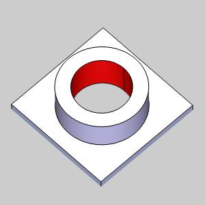

Part 8) Add the Toolpath Pattern
  1. In the CAM Tree, right-click Feature Mill Thread - 2.000, and click Add Toolpath Pattern.
  2. In the Toolpath Pattern dialog box, click Rotate, and click Next>>.
  3. In the Rotate group, set the Angle to 180, and set the Copies to 1.
  4. Because the machining origin is placed at the center of the thread, which is also the center of rotation for the pattern, the Rotation Axis Origin values are X0 Y0.
  5. To compute the toolpath pattern, click OK. The result is shown next.
The multi-start thread is now complete.
